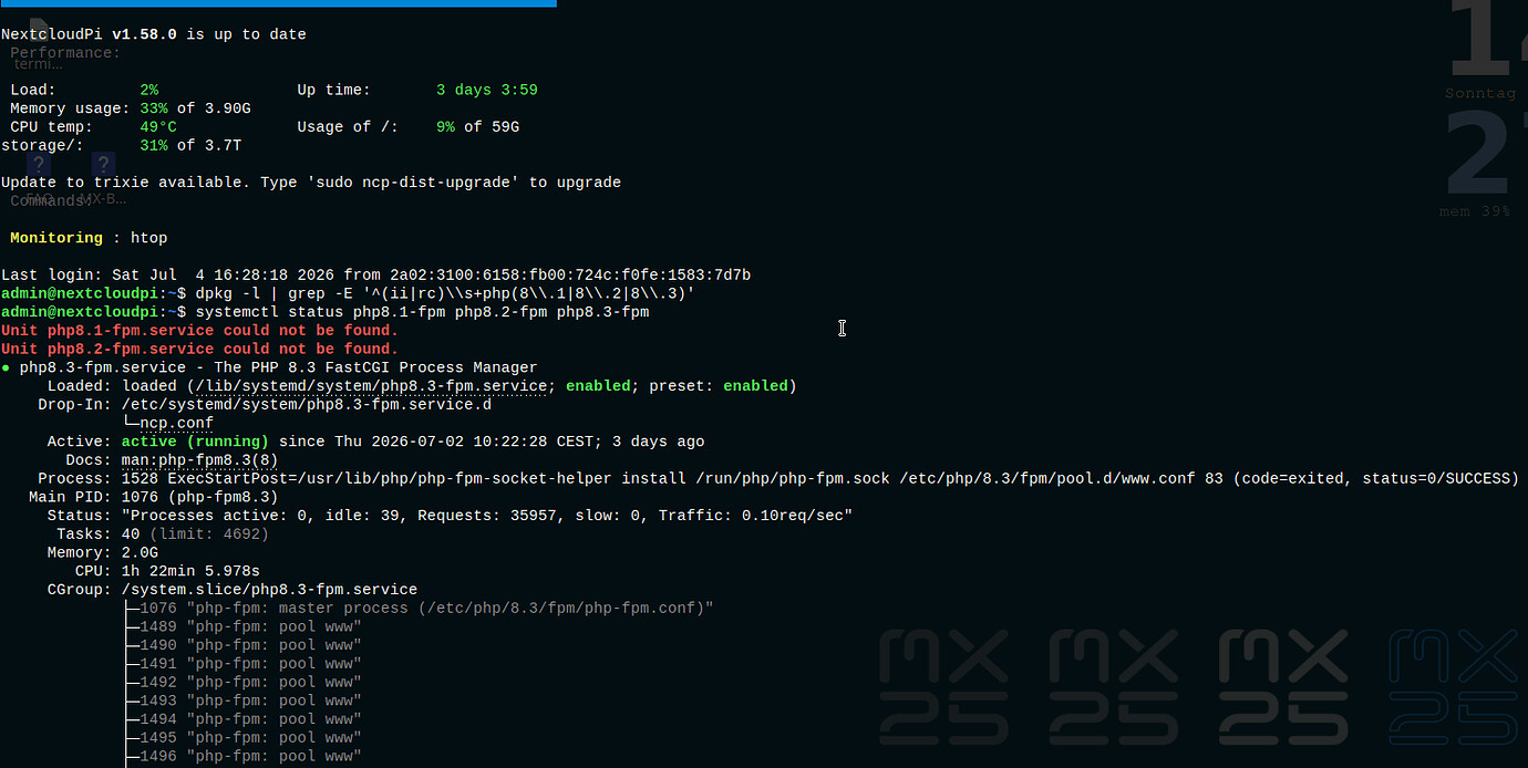

ncp-dist-upgrade is available but cannot be executed as ncp reports the PHP still to be 8.1 although only 8.3.31 is installed
  1. Log on to ncp via ssh
  2. perform sudo ncp-dist-upgrade

Early last year I tried to install ncp on a Pi5 (then latest version: 1.55.0). However the system got stuck while booting in a PHP loop (PHP 8.3). I then installed 1.54.0 (PHP 8.1) which worked fine. I could successfully setup my instance.

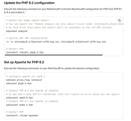

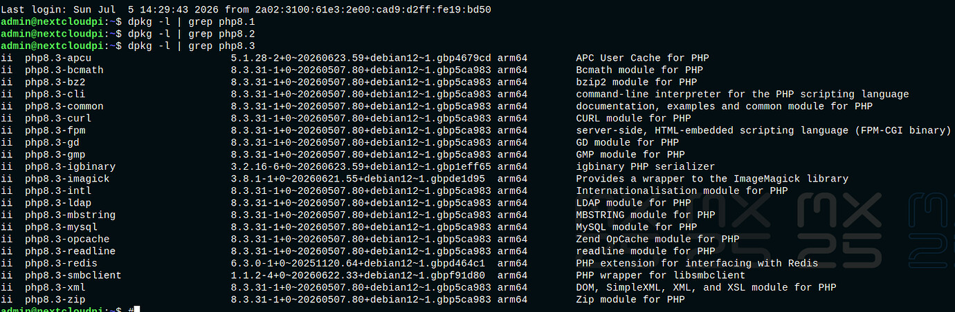

I updated ncp to 1.55.0 - but obviously PHP 8.1 did not update to PHP 8.3 as it was supposed to. I then installed PHP 8.3 manually executing php-updater script and removed all remains of PHP 8.1:
I am aware that I made manual changes to the configuration when I executed php-updater and I understand that this can cause problems. My understanding of the issue is that somewhere - maybe in a config file - the previous PHP version 8.1 is still prevalent. My question is simple: Can this be fixed or would you recommend a reinstallation of ncp?
As my instance has been running smoothely all the time (correctly displaying PHP 8.3.31 by the way) I pretty much ignored the issue but now, in the light of the pending dist-upgrade, I’d like to have it fixed one way or the other.

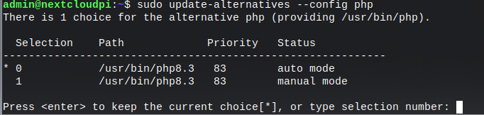

Have you also switched the system interpreter to the new PHP version?
sudo update-alternatives --config php
→ Select PHP version 8.3

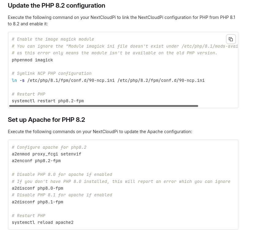

Have you also enabled the new PHP version on the web server?
sudo a2dismod php8.1-version
sudo a2enmod php8.3-version
These two commands disable the old PHP version in the Apache web server and enable the new PHP version.
This allows Apache to determine which PHP version is actually used when web pages are loaded.

I already executed update-alternatives --config php:
I selected 0 for auto mode
The other two commands generate this output:
grafik

Hi @piemaker,
for testing please select the manual mode and try it again. :slight_smile:

What I also had done before I opened this issue here was:
All commands worked fine (using PHP8.3 respectively) but neither of them made any difference. The upper ones were surely useless as I had removed all vestiges of PHP8.1 before. The lines for setting up Apache for PHP8.3 looked promising but had no effect.

What I have found out so far is that the directory /etc/php/8.1/fpm, including the conf.d and pool.d subdirectories, keeps getting recreated.
As far as I can tell, I’ve already removed everything related to PHP 8.1 FPM, and I can’t find any references to it in the Apache configuration or anywhere else that would explain this behavior.
There must still be something on the system that references PHP 8.1 FPM or triggers the recreation of these directories, but I haven’t been able to identify it.

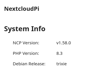

I did some more digging to find out why “90-ncp.ini” kept being recreated.
The cause was that after upgrading PHP manually, PHP had been upgraded to 8.3, but “php_version” in “/usr/local/etc/ncp.cfg” was still set to “8.1”.
As a result, NextCloudPi kept recreating:
“/etc/php/8.1/fpm/conf.d/90-ncp.ini”
even though PHP 8.1 had already been removed.
Fix: Update “php_version” in “/usr/local/etc/ncp.cfg” to match the installed PHP version (8.3 in my case). After that, “90-ncp.ini” is created in the correct PHP directory.

THAT IS IT!!! :folded_hands:
ncp.cfg was not updated to the new php-version, still showed 8.1 - changing this to 8.3 did the trick. Assuming sort of a vestige of an incorrect php-version being prevalent in some config-file was right then.
  • the webserver now displays the correct version:
  • And ncp would finally let me run the update script “ncp-dist-upgrade” which took a hell lot of time to finish.
  • Did a reboot of ncp and now all systems seem to work properly
