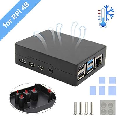

I use that case on Nextcloud.
The fans are a little noisy. Depends on the environment in which it will be installed or your preference.
Idle temperature: 30ÂşC to 35ÂşC
On a raspberrypi 4 Pi-hole I use this:
Passive cooling
Idle temperature: 40ÂşC to 45ÂşC
Cannot see the green and red led’s
I did not tested with heavy loads
I always prefer aluminum cases where the case is also the heat sink
There are many boxes and some better ones
If I bought a box today for Nextcloud I would opt for a passive one (the noise is low but you hear)
