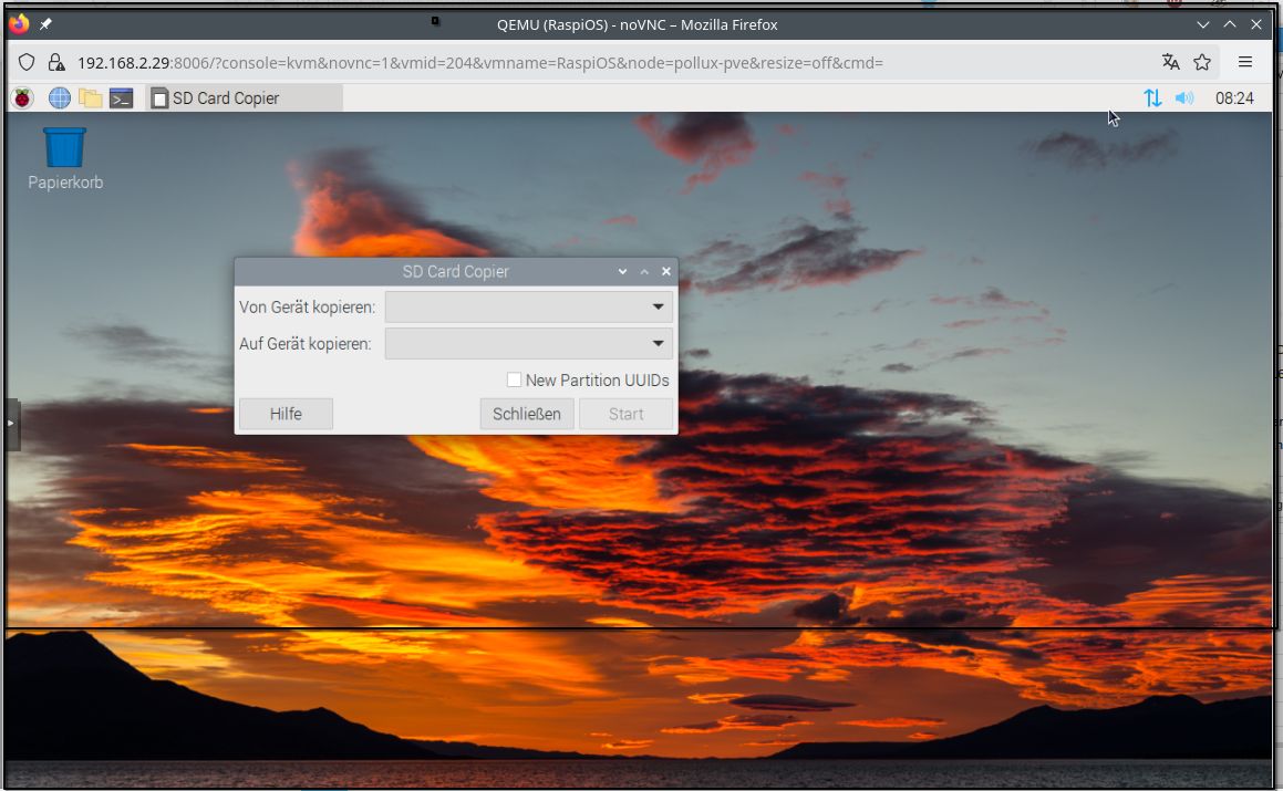

Maybe you have to install it, sd card copier

To get things right, in case of disc hazard we copy the original drive and never zouch again, the first copy is the “mother” of all following copies we need to have during our investigations, no other work is done with it. So we start investigation with 2. gen copy.
In linux you would have seen error/repair messages durin boot time if filesystems would have been damaged., you may examine your sd-copy on your kubuntu system (kdepartitionmanager), with file-manager (dolphin) you may exanine the file tree of the server.
