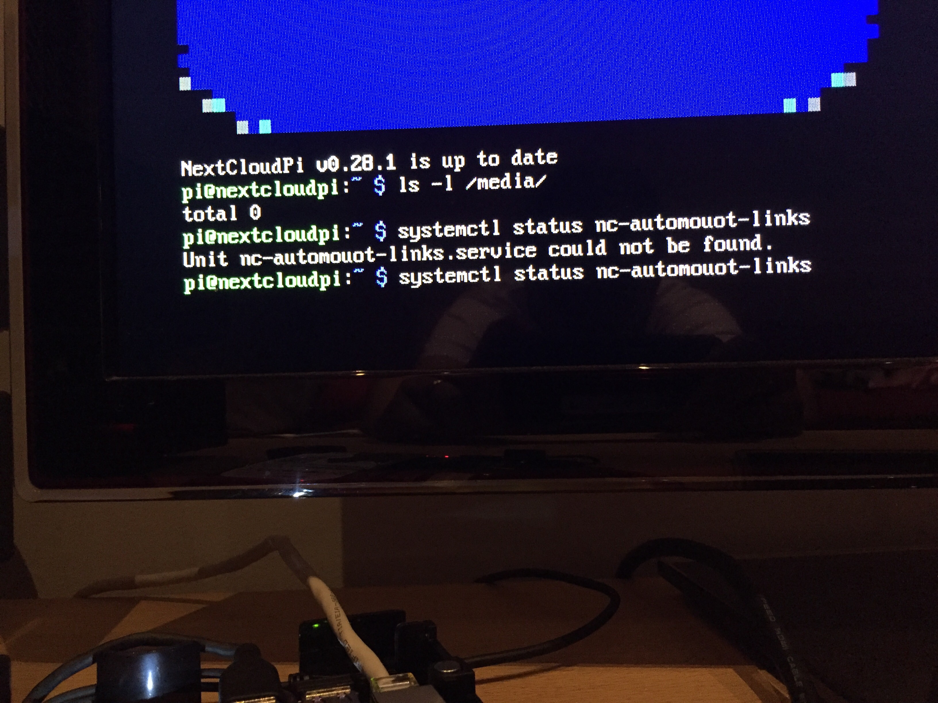

I got this
after ls -l /media/
I get
ā€œtotal 0ā€
and after the last one
systemctl status nc-automount-links
I get
"Unit nc-automount-links could not be found "
you misstyped this one
