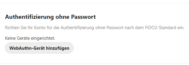

Going further down, we already see that we can set up authentication without a password.
Here we tap on “Add WebAuthn device”

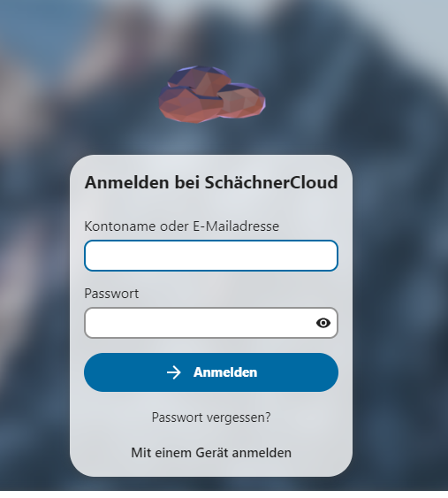

In order to be able to use this tool, we have to tap “Log in with a device” when logging in.
Here we then type in the username and we are asked for the face.

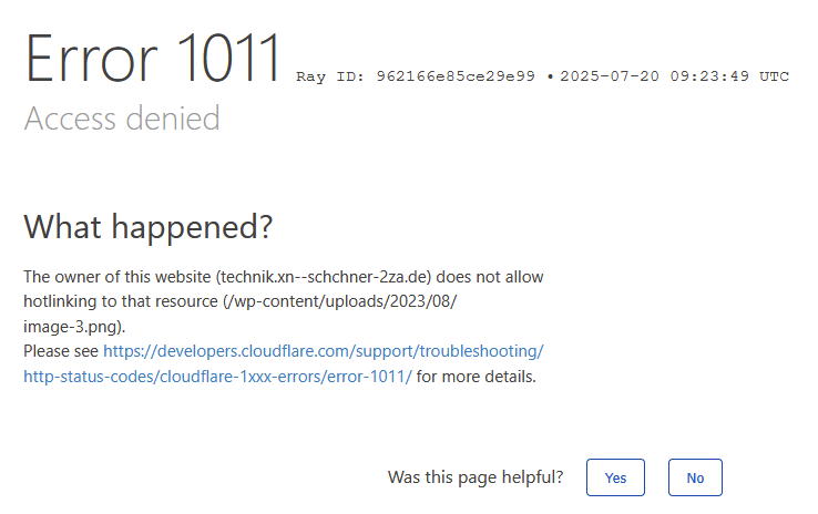

@SchBenedikt some of your images do not show, and opening them independently, an error is shown:
Perhaps integrate the images directly…
Without the snapshots, some information is perhaps missing. But not all WebAuthn devices have a camera? Wasn’t this the option for the U2F devices as well, where then they ask you to put the device in?
Thank you for your suggestion – and I think it works with U2F, too. I’ve now uploaded the images as is and no longer embedded them via a link.

First, it’s important to distinguish between passwordless login and two-factor authentication (2FA) via WebAuthn.
For passwordless login, you don’t need the Two-Factor WebAuthn app, because this functionality is already built into the Nextcloud core. So there’s no need to install any additional app.
As the name suggests, the Two-Factor WebAuthn app is specifically for adding a WebAuthn device as a second factor. In that case, you first log in with your username and password, and then confirm your identity using the WebAuthn device.
Secondly, whether or not you can scan your face depends on the type of WebAuthn device you are using. My YubiKey doesn’t have a camera, so face scanning would be rather difficult! :wink:
