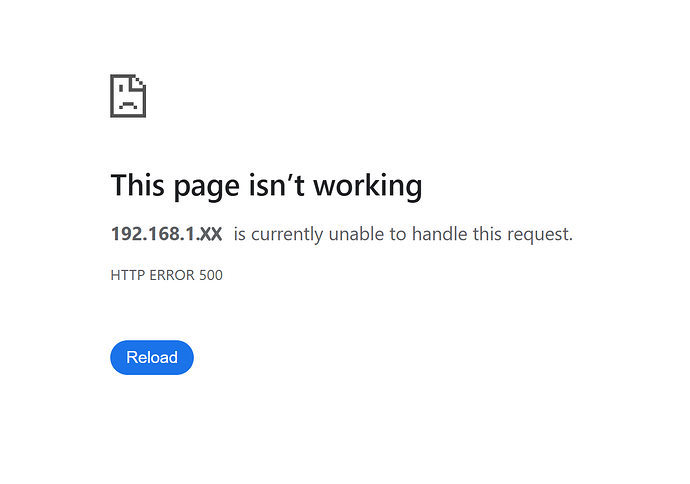

So, I’ve had a Nextcloud installation running happily since the beginning of the year and in most key respects still is. I can still get to the web console.
On Saturday (two days ago), I added the “Password” app and yesterday I can’t access my apps option as shown in this image.
An internet search suggested that this was a known problem, affecting version 32.0.0 of Nextcloud which it turns out I have so the answer is to update, yes? However, running the command, "sudo -u www-data php updater/updater.phar" I either get a “Verify integrity failed” or a “Downloading failed”.
Any advice appreciated :slight_smile:
James
you should urgently update your PHP to a supported version, recommended is php 8.3 at the moment but updating to 8.4 would do it as well
but one step after another… first of all you can deactivate the password-app because I think it doesn’t work with your php-version. So try getting your server re-running again.
if you can’t access your app-page anymore you can use the commandline to disable the app. something like
cd /PATH/TO/NEXTCLOUD sudo -u www-data php occ app:disable NAME_OF_APP
should do the job.
(it’s all in the manual AND mentioned on the forum several times already)
right afterwards your system shoud be running smoothly again.
then it’s highest time to update your php. there’s a good php-update-script made by someone from the forum… take a look here Php-updater - a script to upgrade php in a safe way
after the successful php-update passwords should run again.
A 500 error suggests you need to check your web server and Nexcloud logs. See Admin Manual.
Maybe. I don’t recall and 32.0.0 is 8 maintenance releases behind (32.0.8 is latest). But, yes, you should almost certainly stay up-to-date with maintenance releases - particularly > X.0.0!
However, running the command, “sudo -u www-data php updater/updater.phar” I either get a “Verify integrity failed” or a “Downloading failed”.
Numerous possibilities, ranging from memory limits and beyond. Post the actual full output and check your updater.log for specifics. See Maintenance section of the Admin Manual.
