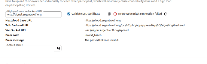

The issue you are facing:
Everything was working fine, until a recent reboot of the Ubuntu server that is running all of the components was rebooted yesterday. Previously, Video calls and chats worked fine. After reboot, Talk is unable to connect to the signaling server and I am unable to join chats on the web client. My phone, however, has been able to post and see new messages on the chat.
Additionally, the Exapps functionality which was working stopped working. In the Nextcloud log there is a message about client version 1.41 is too old. Minimum Supported API is 1.44.
As the Nextcloud log message is truncated, I’m not entirely sure which client needs to be updated.
I’ve tried generating the secret again, restarting the container. I think I attempted to make sure the container was the latest version. NGINX reports errors from the upstream proxy.

"reqId":"YtkgBfdMvv15mv0z1Eeb","level":2,"time":"2025-11-16T16:47:48+00:00","remoteAddr":"2600:1700:4931:757f:7582:1c67:72f4:f6c","user":"USER","app":"PHP","method":"GET","url":"/ocs/v2.php/apps/spreed/api/v3/signaling/welcome/0","message":"stream_socket_client(): Unable to connect to ssl://signal.argentwolf.org:443 (Connection timed out) at /var/www/nextcloud/apps/spreed/lib/Service/CertificateService.php#90","userAgent":"Mozilla/5.0 (X11; Linux x86_64) AppleWebKit/537.36 (KHTML, like Gecko) Chrome/142.0.0.0 Safari/537.36","version":"32.0.1.2","data":{"app":"PHP"}}

2025/11/16 11:46:22 [error] 7355#7355: *78118 recv() failed (104: Connection reset by peer) while reading response header from upstream, client: 2600:1700:4931:757f:7582:1c67:72f4:f6c, server: signal.argentwolf.org, request: "GET /spreed HTTP/1.1", upstream: "http://127.0.0.1:8181/spreed", host: "signal.argentwolf.org"
2025/11/16 11:46:24 [error] 7355#7355: *78120 connect() failed (111: Connection refused) while connecting to upstream, client: 2600:1700:4931:757f:7582:1c67:72f4:f6c, server: signal.argentwolf.org, request: "GET /spreed HTTP/1.1", upstream: "http://127.0.0.1:8181/spreed", host: "signal.argentwolf.org"
2025/11/16 11:46:28 [error] 7355#7355: *78122 connect() failed (111: Connection refused) while connecting to upstream, client: 2600:1700:4931:757f:7582:1c67:72f4:f6c, server: signal.argentwolf.org, request: "GET /spreed HTTP/1.1", upstream: "http://127.0.0.1:8181/spreed", host: "signal.argentwolf.org"
Docker Compose Logs:
talk_hpb  | client.go:352: Client from 2600:1700:4931:757f:7582:1c67:72f4:f6c has RTT of 2 ms (2.09219ms)
talk_hpb  | capabilities.go:128: Capabilities expired for https://cloud.argentwolf.org/ocs/v2.php/cloud/capabilities, updating
talk_hpb  | capabilities.go:369: Could not get capabilities for https://cloud.argentwolf.org/: Get "https://cloud.argentwolf.org/ocs/v2.php/cloud/capabilities": context deadline exceeded
talk_hpb  | client.go:352: Client from 2600:1700:4931:757f:7582:1c67:72f4:f6c has RTT of 2 ms (2.152475ms)
