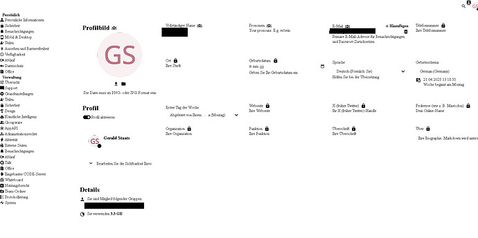

I have a little problem with my nextcloud 31.0.4 on Ubuntu 22.04. After server changing the surface is totally destroyed…
Has anybody a short hint for me ?
