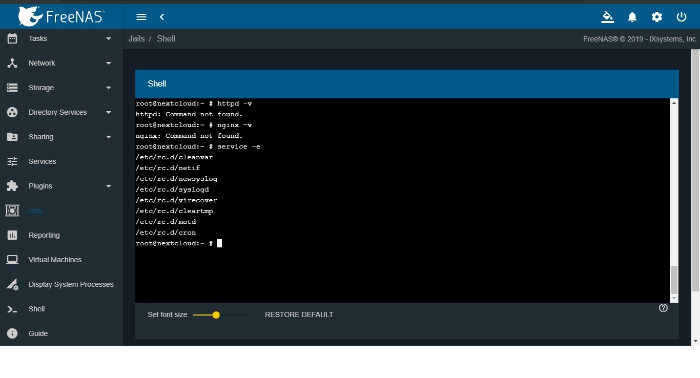

Well Im trying to check apache or nginx version and nothing
Even on started services, it isnt seems to be running anything
