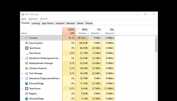

Hey I been encountering an issue and wonder if I am the only one.
I installed a working nextcloud multiple times now and always had the same issue.
As seen in the image my WSL 2 Ubuntu takes all RAM it wants and after that CPU usage goes crazy. Nextcloud / Ubuntu is not responding in this stage. If I clear the ram with the command “sudo sync && echo 3 | sudo tee /proc/sys/vm/drop_caches***”
it seems not to happen.
Any ideas on this ?

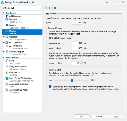

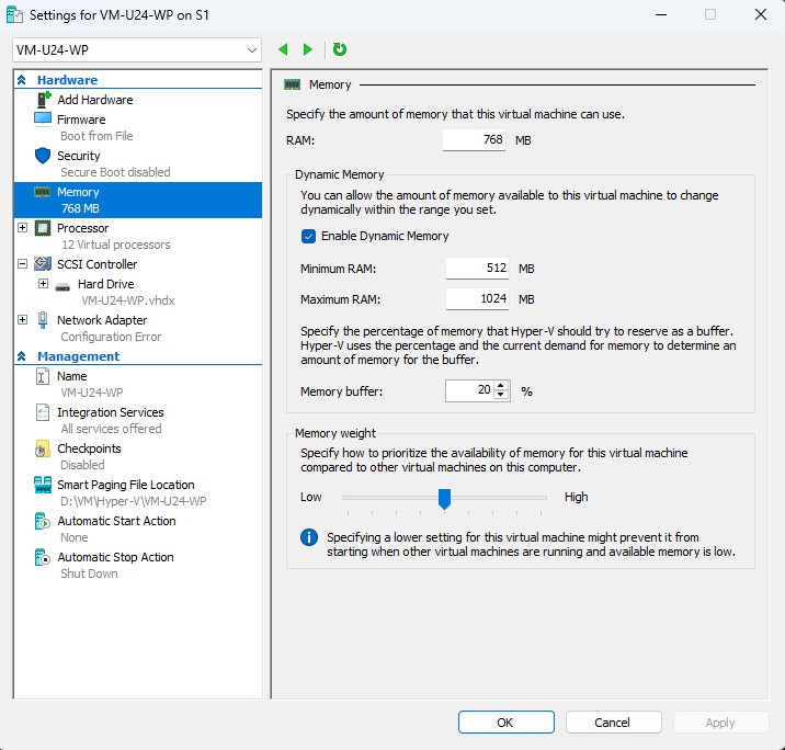

Hello,
WSL2 is basically a VM runs with Hyper-V as it’s hypervisors but much tightly integrated with Windows than a conventional Hyper-V VM. However, underneath, it is a VM layer with Hyper-V as it’s backend.
I have been a long term user of Nextcloud running via Hyper-V and dynamic memory management with Linux or anything apart from Windows VMs are a common problem of Hyper-V.
In theory, Hyper-V is supposed to increase or decrease the RAM allocation based on the RAM requirement of the Guest OS but due to Linux memory caching, it never works out as it is suppose to. Once some amount of RAM is allocated to the Linux Guest, Hyper-V can’t reclaim that back.
However, with Windows as Guest OS on Hyper-V, this feature works flawlessly.
This Dynamic RAM management works flawlessly with QEMU as hypervisor. Where Linux Guest runs on Linux Host.
Coming to the issue now, since WSL2 is just basically a Hyper-V VM, consider running Ubuntu as a standalone Hyper-V VM then deploy Nextcloud snap in that Ubuntu VM. WSL2 wont give you the ability to limit RAM usage but standalone Hyper-V will.
Limit the MAX RAM to something which you can allocate as per your available resources and need of the server.
Thanks.
