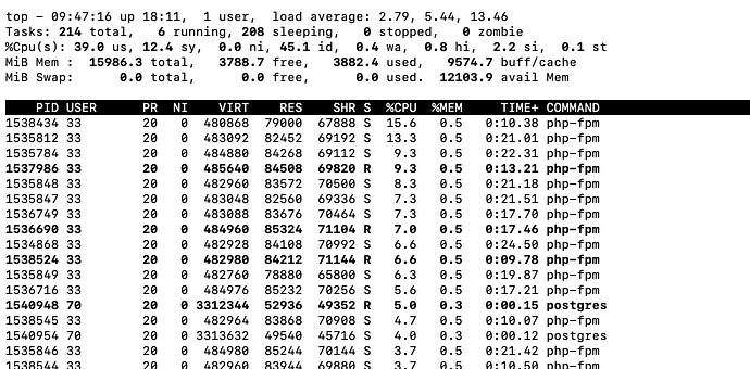

Hello, I’ve been having major issues with CPU usage on my Nextcloud server for a few days now, with the PostgreSQL database that I updated to version 16.3 two weeks ago.
One can see that the CPU problems increase from the moment the users start working:
Docker stats:
top:
Can someone tell me how I can isolate the problem and find out why I need so many resources? I currently have 4 cores and 16GB RAM on the machine. If I increase to 12 cores, it still uses the entire CPU, and I have about 30-40 active employees working on it.

Hi @3d0220fd0f9a5702d0f7 Manuel,
Are you using external storage, or what is the reason you use server side encryption?
You have been warned during activation, that is a CPU-Expensive feature.
I can’t say with absolute certainty whether this is the sole cause; I would have to take a much closer look at your setup, but you haven’t told us that much. :wink:
