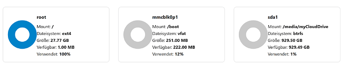

I can’t get past the state that the Nextcloud on my raspberry is using the external USB drive as main storage, everything is put on the SD card next to the os:
I set the nc-datadir and the nc-database to the external device, every check turns green but still continues to work on the SD card.

turned out nextcloud created /media/USBDrive /media/USBDrive1 and /media/myCloudDrive and put everything on the first one while the last directory was the actual USB drive - excuses but, such nonsense
