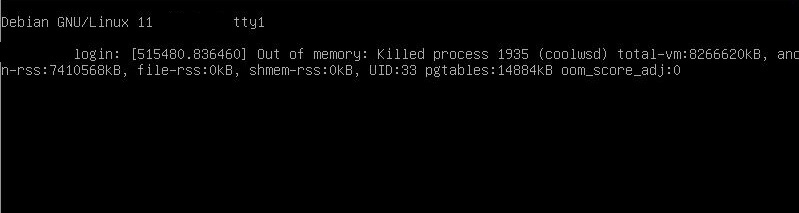

I already had crashes of this type so I put it in a much more powerful server
But now after 5 or 6 days, the server is completely down, and this is what I see in esxi
https://zupimages.net/up/22/42/9k20.jpg

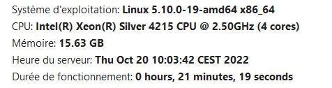

My hardware
The content of /proc/sys/kernel/hung_task_timeout_secs is 120

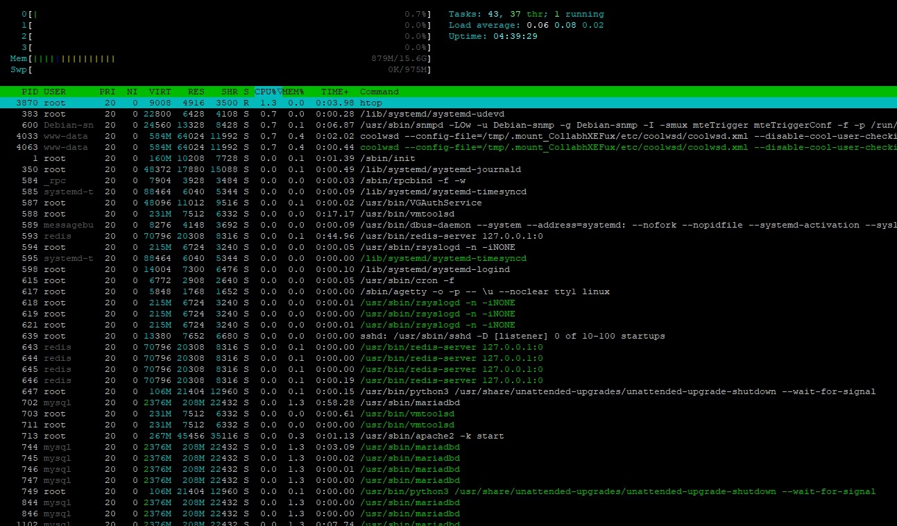

I would start off by determining exactly what resource is overloaded. Try running htop in Debian to get a look at what’s going on. You can also run esxtop on ESXi to see the VM’s resource usage in various ways. Try to determine if it’s CPU, memory, or disk read/write being overloaded, and by what process.

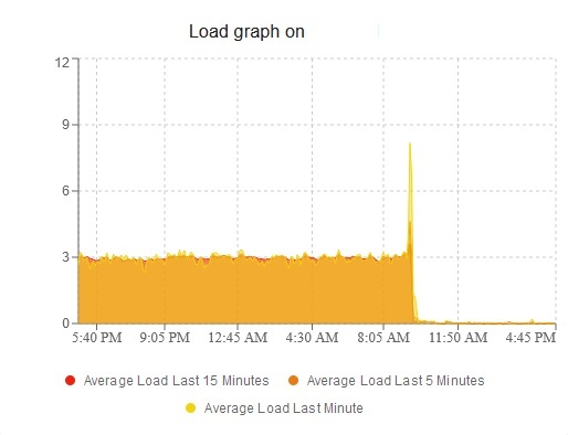

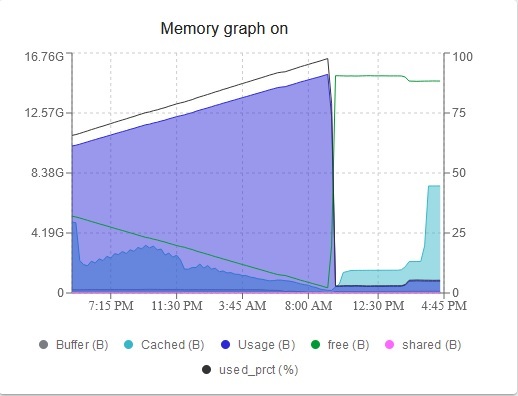

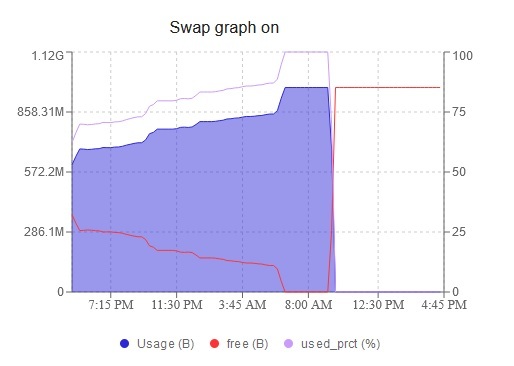

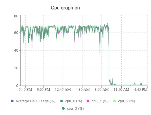

Hello
For information, here are the load graphs of my Nextcloud server this morning, before the reboot, collected by Centreon
your system is pretty powerful, depending on users count maybe some memory shortage. you graph show classic resource leak. Maybe you can share you user/usage metrics so we better align it to our experience (lot of forum user use RasPi or SoHo NAS). I don’t remember others reported such behavior - but maybe because majority of the users are not expert enough to analyze the issue as good you did.
the crash you reported in the first post shows coolwsd which is Collabora component - do you perform lot of/huge office document work… many users? would be great you can isolate the process eating CPU and memory so we can focus on specific components?
I agree it looks like a leak, in particular because of the way it fills up memory and then fills up swap too. When it starts doing that again, you can use htop to find the responsible process.
yes, I have quite a few collaborators (between 10 and 15) who work a lot with collabora online and indeed, it has been responsible for quite a few server crashes in its old configuration with “out of memory” alerts.

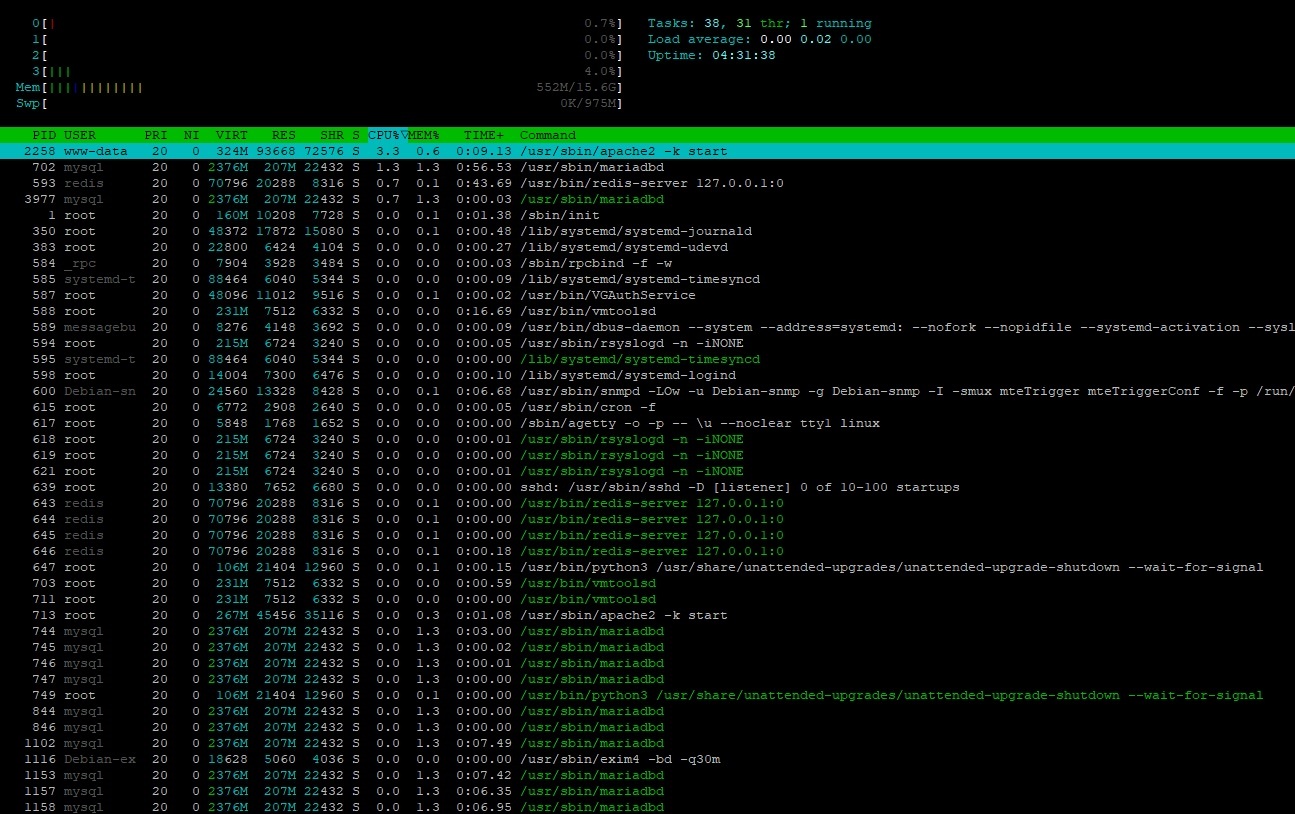

As I suspected, the problem of RAM saturation comes from collabora, here is the proof:
So I launched the commands
kill 28803
kill 41378
And everything is back to normal, but this is not a viable solution, there is a problem somewhere.
