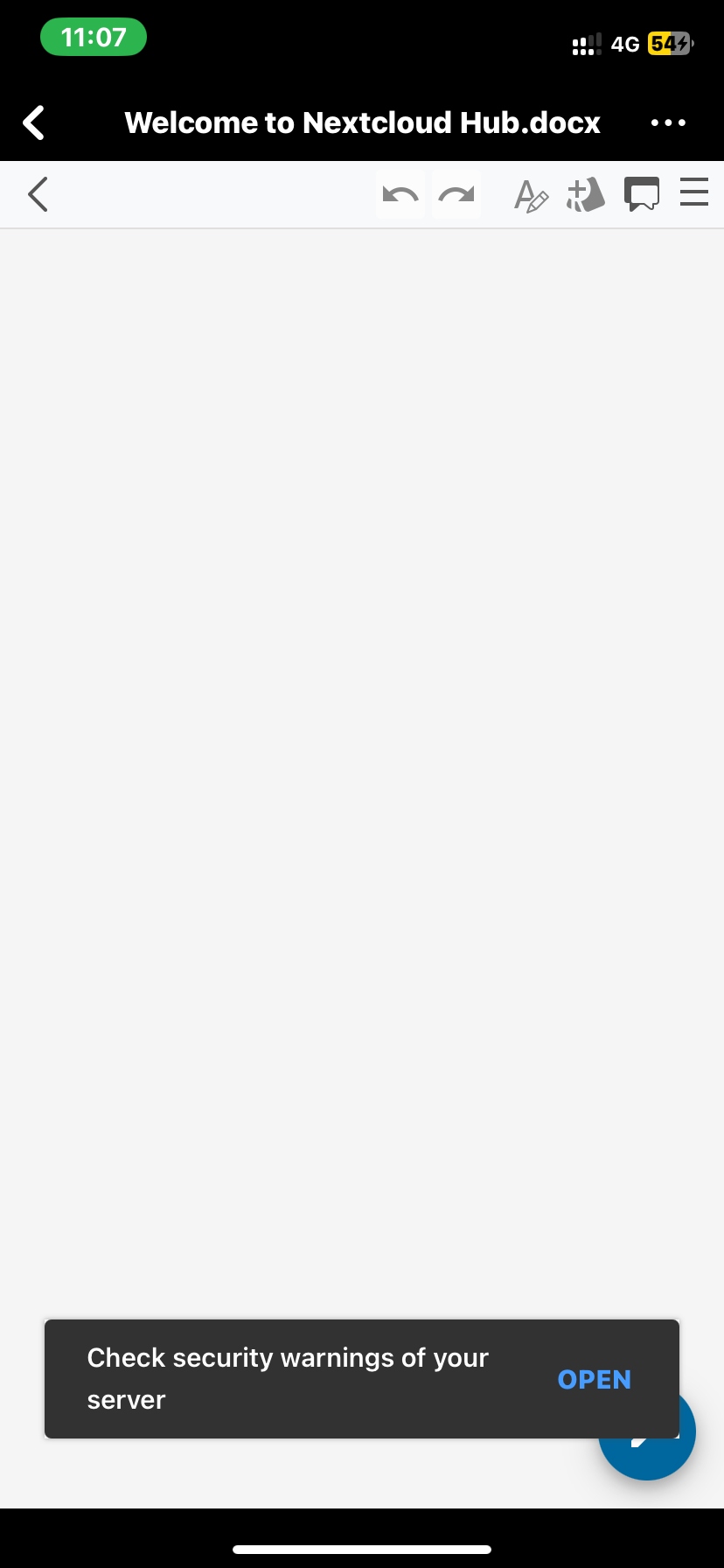

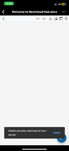

I have an issue where I can load documents and edit them just fine in the browser on my laptop and mobile devices. However, if I use the iOS app, it opens the file to a blank screen, says i have joined the document and then ā€œConnectingā€ just stays at 0%.

Phone iOS 18.1.1 with Nextcloud Hydrogen for iOS 6.6.4.5 loads document for editing but only see a white page with a blue pen circle icon at the bottom right.

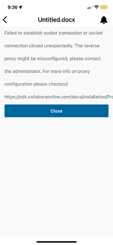

On the iOS app, I’m seeing ā€œFailed to establish socket connection.ā€ See attached.

For me ODS (spreadsheet) loads correctly and works fine, but docs (docx, odt) just show blank.

WRT @midnight-taco showing the failed to establish a socket error, I believe that is after the phone has gone to sleep and is related to reverse proxy settings, atleast in my case it does not happen during load so I believe this issue is unrelated.
@the_dude_abides can you confirm if you are using AIO, and if it only affects documents not spreadsheets the same as me?
@kinhswch I do not see any security warnings, so again not sure that is related you might have some other configuration issues yourside…

Clarifying that the ā€œFailed to establish socket connectionā€ screen appears, I believe, after I leave the doc page open a little longer. I don’t know if it is related to or a side effect of docs not loading on the NextCloud iOS app, but wanted to include that finding.
