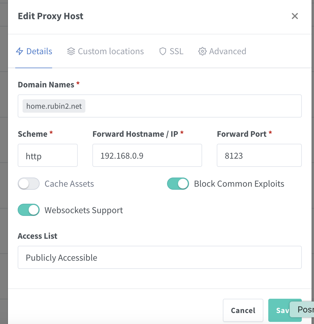

I have a server with proxmox installed and running there some VMs and some CTs. I hvae everywhere static IPs set up and the main modem has an static public ip with open port 81, 80, 443 to the Nginx proxy manager, which is installed on the same machine–>proxmox VE.

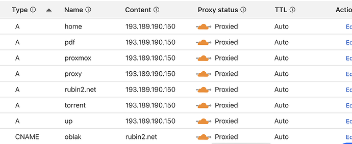

I have a registered domain (rubin2.net) and use cloudflare to set my dns settings. All my services (proxmox, NPM, sumatrapdf, home assistant, web torrent, uptimekuma etc.) everything has its subdomain and its reacheble from the web. But i cant setup a subdomain in the proxy manager. And i cant access nextcloud via my domain “oblak.rubin2.net”. The domain and all ips are added in the config file in the section “trusted domains”. But still no luck. I tried to change the CNAME and A records in Cloudflare but its not working. What am i doing wrong, why i cant access nextcloud from the web-externaly?
