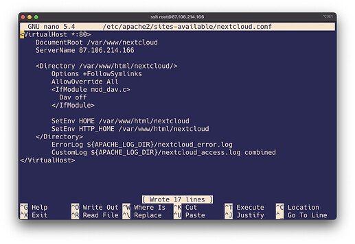

sudo nano /etc/apache2/sites-available/nextcloud.conf file :

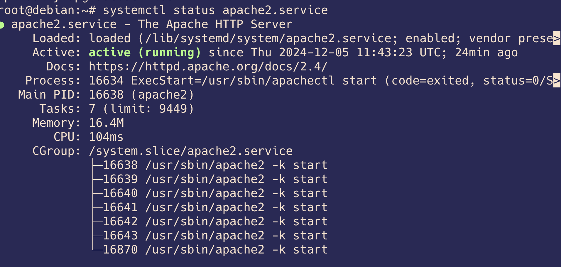

systemctl status apache2.service :

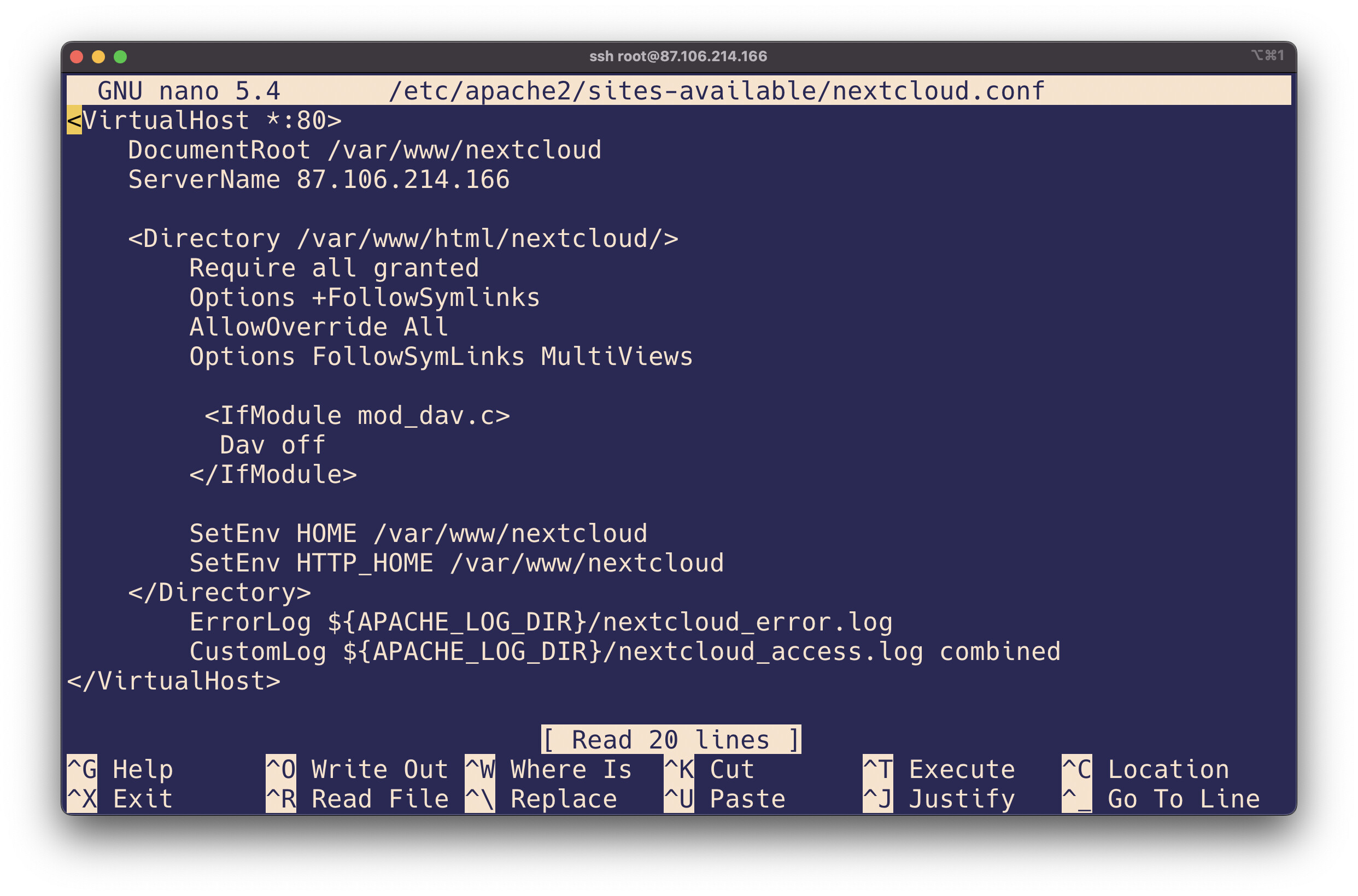

It may also be helpful to align the directory section in your configuration with that in the official documentation, specifically by adding/extending the following two lines:
Require all granted
Options FollowSymLinks MultiViews
https://docs.nextcloud.com/server/latest/admin_manual/installation/source_installation.html#apache-web-server-configuration

And i add the two lines on the Apache configuration file.
When i try to set up nextcloud via opening the server of mine i become same screen.

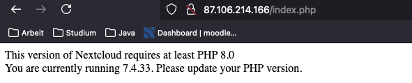

Hello @bb77 i changed some config files and now i am getting now
“This version of Nextcloud requires at least PHP 8.0
You are currently running 7.4.33. Please update your PHP version.”

I must find a way to update the php of my server which is not really easy to find. (I tried it earlier) :smiley:
If you are on Debian or Ubuntu, you could upgrade your system to the latest release, Debian 12 or Ubuntu 24.04, which ship with PHP 8.2 or 8.3 respectively. Or, if you can’t upgrade your distribution for some reason, you could try the following script: Php-updater - a script to upgrade php in a safe way
The issue was that i tried to install on Debian os but then I was not able to install PHP latest version so I installed again on Ubuntu and problem solved :slightly_smiling_face:
I solved it instead of installing on Debian i just installed on Ubuntu and problem solved thanks for your help :slightly_smiling_face:
