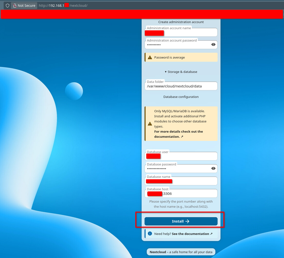

[I followed the server admin documentation to build out my server from the ground up. The application loads the install page without issue, but clicking on the “Install –>” button does nothing. It will switch to “Installing…” briefly and reload the page while leaving the values in place with no errors.

Essentially, I click this button and nothing happens. Says “installing” briefly and then flashes back to Install –>. Can do this over and over again.
That behavior usually happens when PHP can’t write to the Nextcloud directory or the database setup fails silently. Double-check that your web server user (e.g., www-data) owns the Nextcloud directory and has full write permissions. Also make sure PHP 8.4 is fully supported — it’s quite new and may cause issues. If possible, try PHP 8.3 instead. Finally, check your browser console’s “Network” tab for any failed requests when clicking “Install”; it often reveals the real error.

So the problem here is that install run in loop without doing anything ?
This is a wellknown issue on Nextcloud 32, there is a long thread here about it.
Thanks for the replies! @artlog1 I appreciate the referral, I kept thinking there’s no way I am the only one and I felt bad writing this post but I couldn’t find it by using the search terms I was using.
@honduken i was involved in the previous thread that’s why i found it, and you are right you were certainly not the only one. You were right to open that in your wording, this will increase visibility of this issue.
