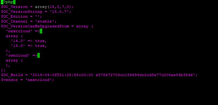

We had an issue that caused our nextcloud environment to crash. The database crashed and the webservers fell out of sync. I have spent the morning getting everything back up and operational, but now my second webserver has locked me out of the GUI and is forcing me to upgrade before I can get into it again. Any Idea why this would be happening?

Both servers are indicating they are on the same version (15.07) (screenshots attached)
I have also included a screenshot of the upgrade that suddenly appeared.
Any ideas on how I should proceed, if I should upgrade?
We currently have all traffic going through the load balancer and it only using the first webserver, but there is a reason why we have 2.

Yes, it forces updates. On version 14.0.3. The way to fix it is to set the config to “production”.
php occ config:system:set --value production updater.release.channel

There is no forced update for Nextcloud.
The third screenshot is the web based version of occ upgrade
. It’s possible to disable the web based version if you want.
It’s required to run occ upgrade
(via cli or web) after the updater downloaded and extracted a new Nextcloud version. But the updater (download and extract) is not called automatically. If you run into the web based occ upgrade
one run the updater before.
It does have similarities to that issue. The main difference is that this happened suddenly over the weekend for no discernible reason. The update appears to have been automatically downloaded. Why now? We are on 14, why would it suddenly download automatically now? Why should it lock the interface just because the update was downloaded? Perhaps that’s a bad design.
