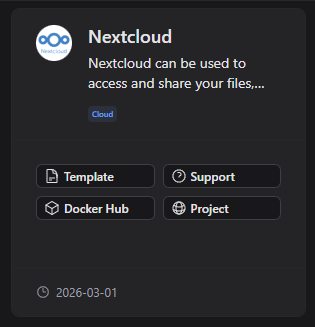

Sounds like you’re using an Unraid app. Underneath it does use one of the various Nextcloud images, but…
Anyhow, the WhatsNewController doesn’t exist in v33 so no idea how you’re even seeing that.
What’s your volume/mount configuration for the container? You may want to post on the Unraid forum for support, as Unraid lists on the support link for that app.

When you say i’m using an Unraid app. yes i believe so. in my eyes an Unraid app was just a template to a preconfigured set of docker parameters. i don’t see the unraid apps list a link straight to the exact one app, but it this one:

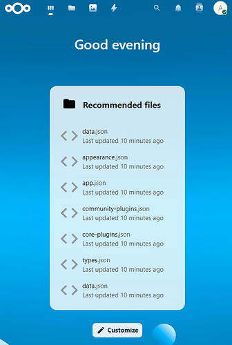

okay, solved it i guess
Since i found the file generating the error using grep -rnw ‘/mnt/user/appdata/nextcloud2’ -e ‘WhatsNewController’
Being this is a search that reads all file contents, I also noticed…. if this file was used anywhere, more results would be there, showing that file was imported. i’m not familiar with php at all, but there would have been something…. anything! so, i renamed WhatsNewController.php placed in /appdata/nextcloud2/nextcloud/core/Controller to WhatsNewController.php.OFF and restarted the docker.
Now i’m welcomed by a running web interface and everything that should be connecting with it is working again.
so, i can’t be sure if that file came from the unraid shell of nextcloud, or was a leftover from a migration, but i think it can be deleted safely.
