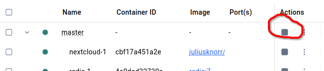

Starting and stopping in docker.desktop:
There should be no need to add anything, please remove the depends line for now.
You need to start the container, so inside the nextcloud-docker-dev directory so „docker compose up -d phpmyadmin“. Then the container should be visible in desktop as well.
