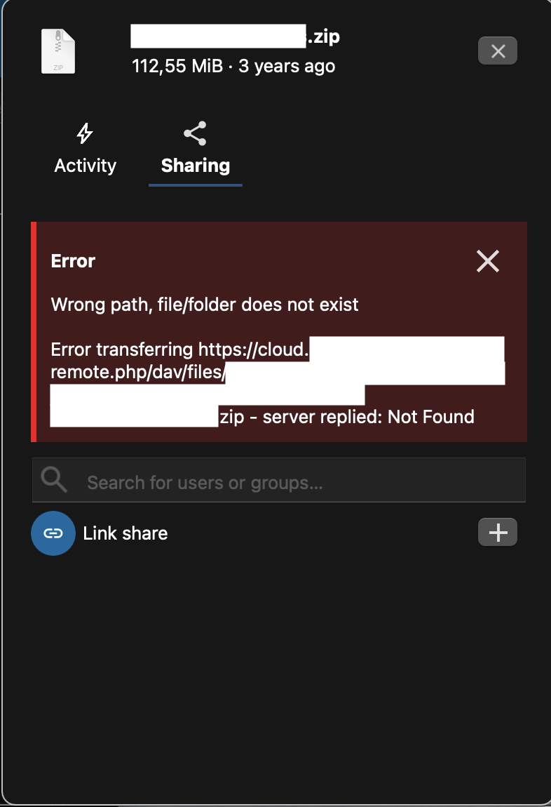

I am using the Desktop Client to sync files from my MacBook to my Cloud. Most files work, even large ones, but some don’t. The Desktop Client shows this error:
On the server side, in the logs I can see this error all over the place:
BadRequestExpected filesize of 104857600 bytes but read (from Nextcloud client) and wrote (to Nextcloud storage) 54018048 bytes. Could either be a network problem on the sending side or a problem writing to the storage on the server side.

Cloudflare has two big limitations: 100MB (which can be worked around with chunking configuration) and maximum request time.
What happens when you upload the same file via the web UI?
All of the files have been over 100MB, and I also know about the cloudflare limit, but because of the chunking, I thought that it could not be the problem. Request time could have been the issue. It was the first time syncing all my documents (roughly 50GB), so it may have been the amount of files (thousands) in combination with slow transfer times. I actually didn’t try over the web UI. I also didn’t want to mess with the php.ini because I am using nextcloud aio. But for some reason, it just worked. I assume, it just retried over night a couple of times and eventually it worked. Sorry that I can only make assumptions for everyone reading in the future.
