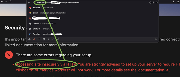

Recently installed Nextcloud and it is complaining, in the Overview section of the Administration settings, that I am “Accessing the server insecurely via HTTP” while the connection has a padlock indicating HTTPS (and the URL bar shows HTTPS), as shown below:

If your proxy is not indicating HTTPS is in-use (via the X-Forwarded-Proto header) to Nextcloud, try setting overwriteprotocol to https (docs). This will force it.
You may also consider (after that):
  • setting the overwrite.cli.url to an https one

Hi, thank you for your quick and helpful answer. This has solved all my problems. Nextcloud no longer complains, and a weird document list error I had seems to be fixed. Thank you.
