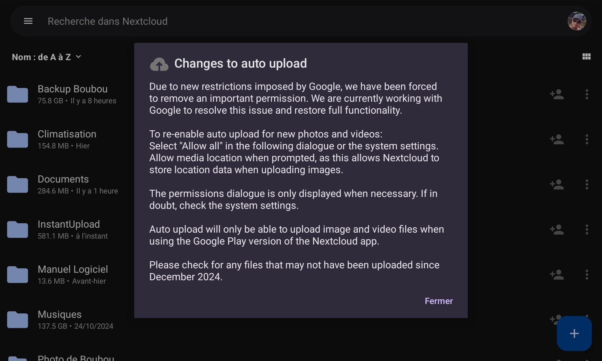

I reinstalled the app, then I got this message:
I granted everything that was possible to authorize, deactivated the battery optimization for nextcloud, the uploads are done after 10 to 30 min …
