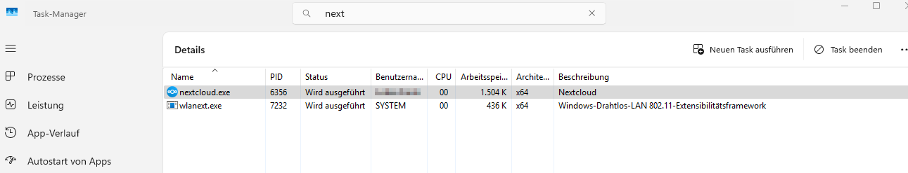

Hi, thanks for the quick reply.
I tried it and removed some applications from the startup, but unfortunately, it didn’t work.
The Nextcloud client simply won’t start. Even reinstalling with the latest version didn’t help. Interestingly, I can see in the Task Manager that Nextcloud is somehow running in the background, but I don’t see a task icon or a GUI, etc. Background synchronization isn’t working either.

I see an “Action required” mark in your first screenshot at the “Security”-shield (yellow exclamation mark). Check it, maybe you will need to grant access to Nextcloud.
Did you set a default browser? Try to select a different browser, maybe Nextcloud cannot start the browser for first login.
Don’t forget to check the Windows eventviewer under Windows-Events - Application and security, whether there is an error- or warning entry concerning Nexctcloud client.
In a command windows run taskkill /f /im nextcloud.exe then try again.
