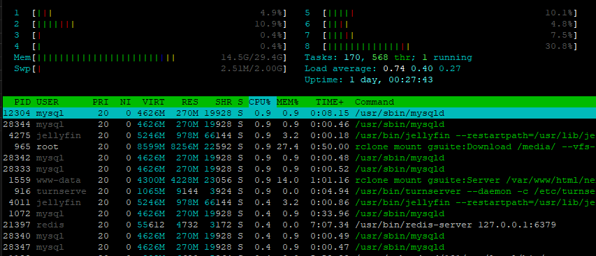

I think the problem must be Nextcloud or the database.
Can you while uploading test some values with top, htop, free, iotop, netstat, and post them?
Also there are some infos to performance-optimation in the internet.
W_H
April 24, 2020, 10:31am
8

A lot of sockets. Perhaps you can find the processes with lsof (must install):
lsof
lsof -i
And you use swap. Please deactivate swap
swapoff -a
test with
free
Perhaps deactivate permanently or set other values.
Perhaps you can also temporary deactivate “rclone”-processes because of memory.
