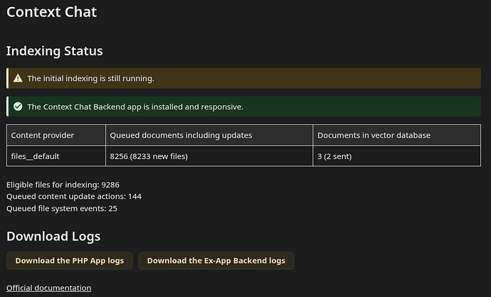

Small update from my side.
I checked Nextcloud Assistant Context Chat again and can now see at least some progress.
The backend is currently shown as responsive, files__default is visible again, and the page now shows 3 documents in vector database (2 sent).
So it does not look completely stuck anymore, but the behavior still feels inconsistent because I have already seen it switch between unavailable, malformed stats, and now partial progress.
I am attaching a screenshot of the current state.

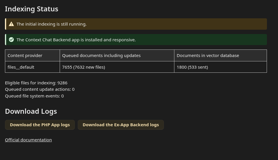

Another follow-up from my side.
I did some additional debugging on the server in parallel and eventually paused the files_antivirus app, then later disabled the whole ClamAV module in the Nextcloud AIO backend and regenerated the AIO containers.
After that, the indexing finally started moving properly.
Current state:
  • backend is responsive
  • files__default is progressing
  • queue dropped to 7655
  • vector database now shows 1800 (533 sent)
So in my case, there seems to have been some relation between this behavior and the antivirus / ClamAV side as well.

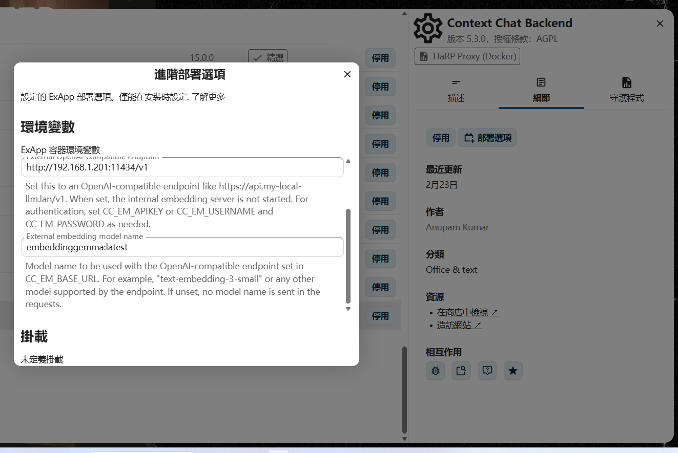

In my setup, I connected the Context Chat Backend to a local Ollama instance at http://192.168.1.201:11434/v1 and I am using the embeddinggemma:latest model.
To push the indexing process, I manually executed the following commands in my Nextcloud Docker container:

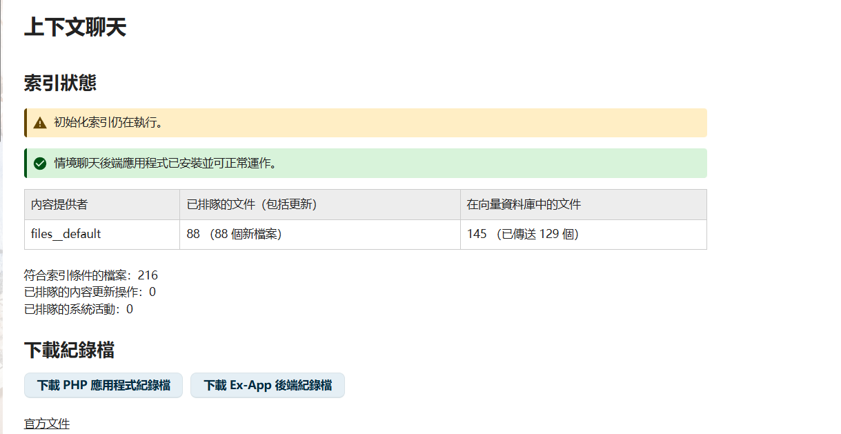

After running them, my current indexing stats look like this:
root@pwx:~# docker exec -u www-data -it nextcloud php /var/www/html/occ context_chat:stats
ContextChat statistics:
The indexing is not complete yet.
Total eligible files: 216
Files in indexing queue: 88
New files in indexing queue (without updates): 88
Queued documents (without files):array (
Files successfully sent to backend: 129
Indexed documents: array (
  'files__default' => 145,
  'mail__mail' => 1,
Actions in queue: 0
File system events in queue: 0
However, no matter how many times I run the indexing commands, those 88 files always remain in the queue and fail to be indexed. It seems completely stuck.
Have you experienced a similar ceiling or stuck queue in your setup? Any insights would be greatly appreciated!

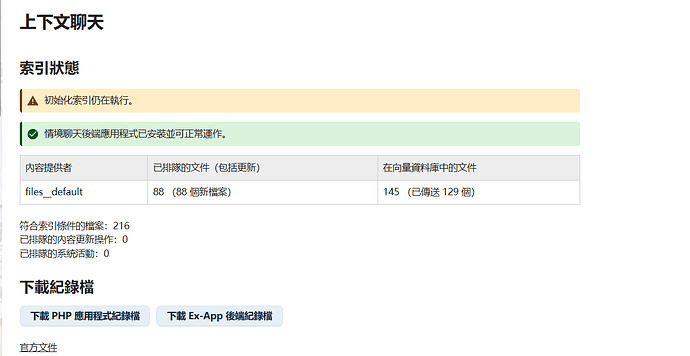

I just tried a similar approach based on your experience. I disabled the files_antivirus app, deleted the Context Chat backend, and then re-created it from scratch.
After that, I ran the indexing command in SSH again:
docker exec -u www-data -it nextcloud php /var/www/html/cron.php "OCA\\ContextChat\\BackgroundJobs\\IndexerJob"
Here is the current status:
  'files__default' => 6,
Actions in queue: 0

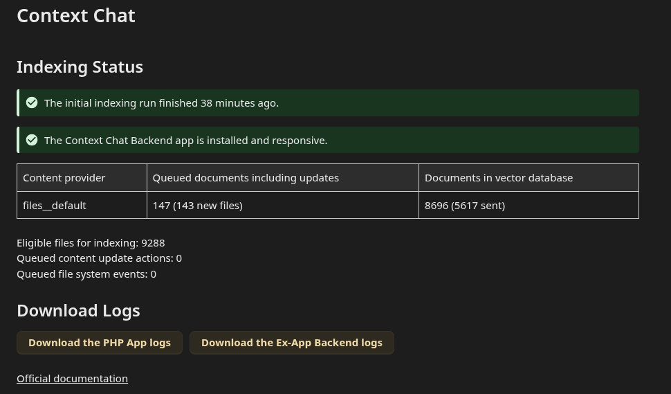

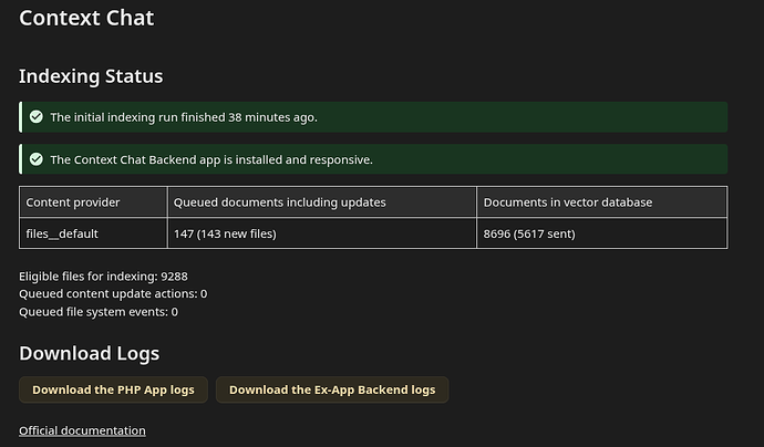

Small follow-up from my side.
The initial indexing run has now finished.
Current state:
  • files__default is at 8696 documents in vector database
  • 5617 sent
  • remaining queue is 147, including 143 new files
So at this point the situation looks much better than before. I am attaching a screenshot of the current status and for now I will just keep monitoring whether those remaining queued files continue to go down.
