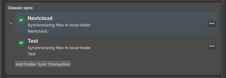

[…]I installed the desktop on a new client (running ZorinOS). I set up the folders (actually only a single folder) to sync. It proceeded to sync and shows a green checkmark on the icon.
Note that on a prior client, running Ubuntu, the older version of the desktop app (where you had to manually configure all sync’d folders) worked flawlessly.
  1. Updated a file in the folder which is sync’d (i.e. an application updated a file in the sync’d folder)
  2. Observed no change in the file on the Nextcloud server and no log entry (in the desktop app log) showing a file was updated. No visible change to the NC app’s icon (the older app would show a sync was in progress)
  3. Also uploaded a new file (different) to the Nextcloud server using the NC files app. This file has not been replicated to the sync’d folder on the client.
Also, I tried several manual sync operations. No change in the results, and the manual sync process completes (if it even does anything) essentially immediately. Therefore I suspect it’s not doing anything at all.

I’m not using the AppImage; I’m using the app installed via the PPA.
Just now, I did a test. I created a separate test folder (only on the client). Then on the NC desktop app, I created a sync folder manually:
This method seems to work correctly. Right after I created the sync connection, it created the folder on the server and uploaded the 4 test files I had place in it. I then deleted one of the files from the server end, and it properly deleted it on the client.
I will create a manual sync connection for the real data folder that I want sync’d to the server, and see if that resolves the problem.
Edit (update): that solved the problem. Manually creating a sync connection correctly uploaded the files. I then altered a file in the source folder on the client, and it immediately replicated to the server.
Bottom line: classic sync using manually created sync connections works. The method of selecting/deselecting folders on the client, when the desktop app originally presents itself, does nothing (at least, that’s what I have observed).
