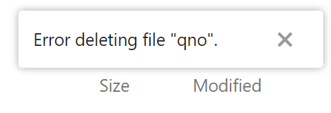

Hi all.
I have a master-slave setup and Maxscale in front of it, in RW Split mode, but 'im facing a problem: i can’t delete folders/files. I can upload, move, copy, etc, but each time i try to delete, i get an error.
  • If i disable Maxscale and route all traffic to a single server, no problems.
  • With Maxscale enabled BUT one server off (so Maxscale only sees one server and all traffic goes there), no problem
  • With Maxscale and the two servers enabled, one master for Writes and one Slave for Reads, i can’t delete files or folders. Everything else works (apps, users, uploads, etc…)
Any idea from you guys?
