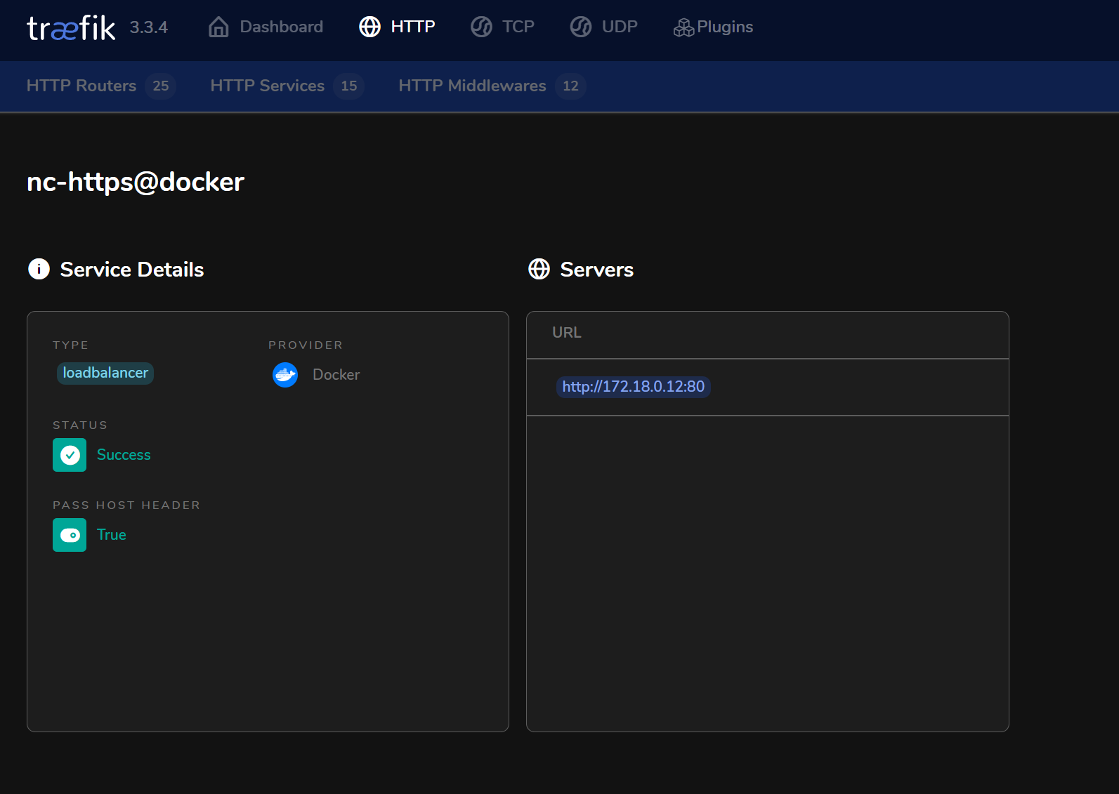

However, I found a problem when deploying this, I don’t see in Traefik the url that you set but the docker IP of my master container instead of the apache one. I attach a picture of it.
It seems that Traefik is correctly reading the labels, but ignoring the one where you set the url. Do I need to reconfigure something in Traefik?

About one year ago I tried exactly the same thing serveral times for several hours until I found out that it was not supported by Traefik to use a server-url provided by a docker-label. Configuring it with a file wasn’t possible either as the server’s name can’t be resolved there.
Today after I read your post I spent again some hours trying until I fortunately had the idea to updated Traefik to the newest version.
=> Now I found out taht this feature is supported since Traefik V3.4.0, see the release notes: [docker,ecs,docker/swarm,consulcatalog,nomad] Allow configuring server URLs with label providers (#11374 by yelvert)
