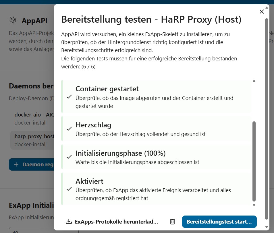

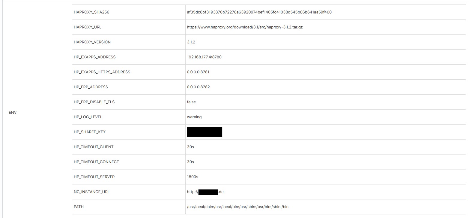

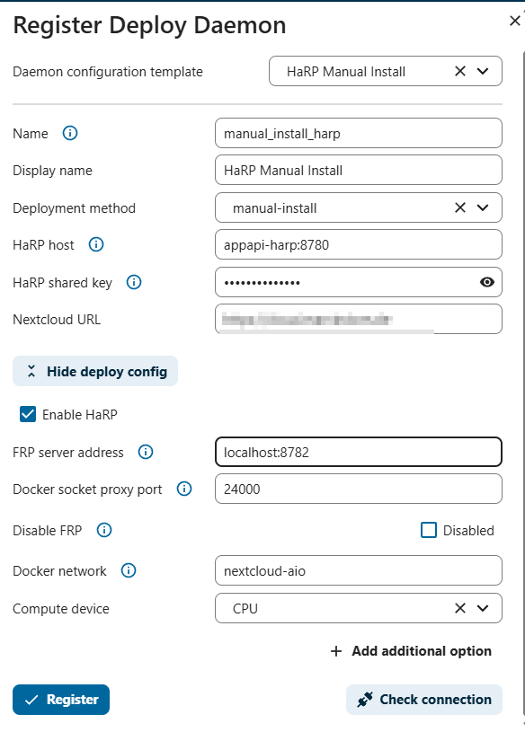

I installed the Harp AIO container.
The Test connection works but the Test Deploy fails always. He isnt showing any progress in the window and returns a heartbeat error at the end.

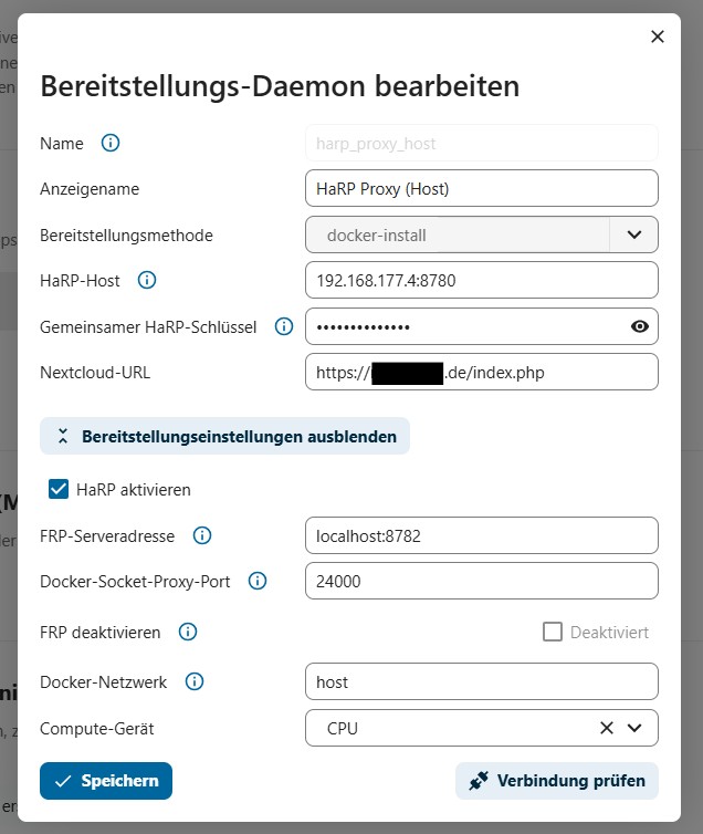

In the reverse proxy under exapps, you need to specify the internal IP address of your Nextcloud as well as the port of the AppApi-harp container.
Example:
location /exapps/ {
    proxy_pass http://<interne IP>:8780; # IP address of the Docker Server and Port-Number
    proxy_set_header Host $host;
    proxy_set_header X-Real-IP $remote_addr;
    proxy_set_header X-Forwarded-Proto $scheme;
Hi Thomas,
i configured this right now but it wont help. Do you see any problem?:

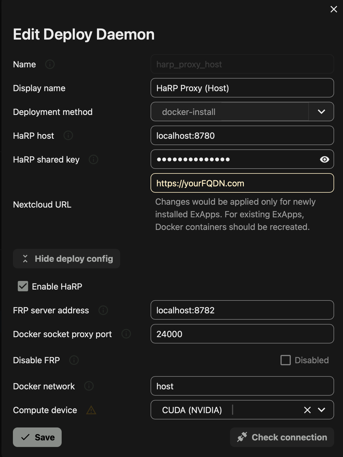

Something is configured wrong - your instance should connect internally using http://appapi-harp:8780 directly. Your Nginx configuration works from outside, so in case anything looks for https://yourFQDN.com/exapps/ directory, this setting in Nginx proxy allows for communication. However what I can see in your error log is that the NC instance wants to connect to HARP proxy using the docker name (appapi-harp) on port 8780 - but it adds /exapps/ to the URL, which I believe will not work.
In your AppAPI daemon settings make sure your configuration looks like this:

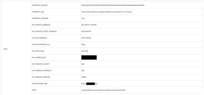

! NC_INSTANCE_URL is only HTTP and that is correct !
sudo docker run \
-e HP_SHARED_KEY="PASSWORD" \
-e NC_INSTANCE_URL="HTTP:/YOUR-DOMAIN" \
-e HP_EXAPPS_ADDRESS="YOUR-INTERNAL-IP:8780" \
-v /var/run/docker.sock:/var/run/docker.sock \
-v pwd/certs:/certs \
--name appapi-harp -h appapi-harp \
--restart unless-stopped \
--network host \
-d ghcr.io/nextcloud/nextcloud-appapi-harp:release

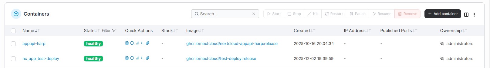

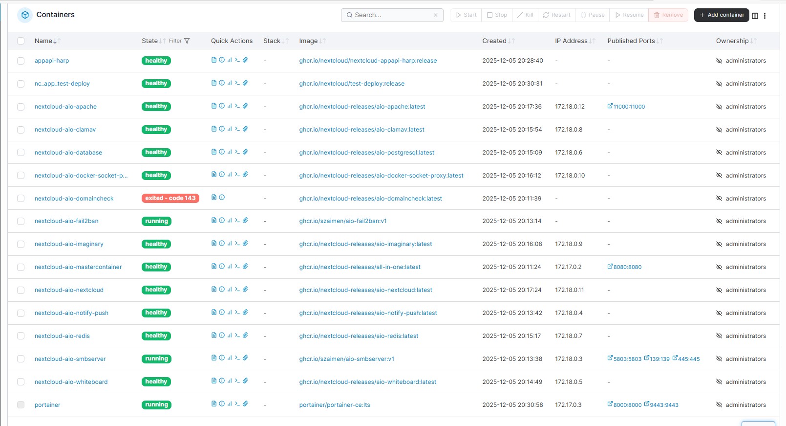

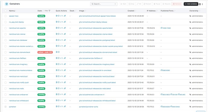

This results in the following container in Portainer, for example:

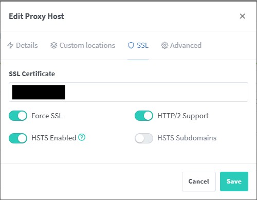

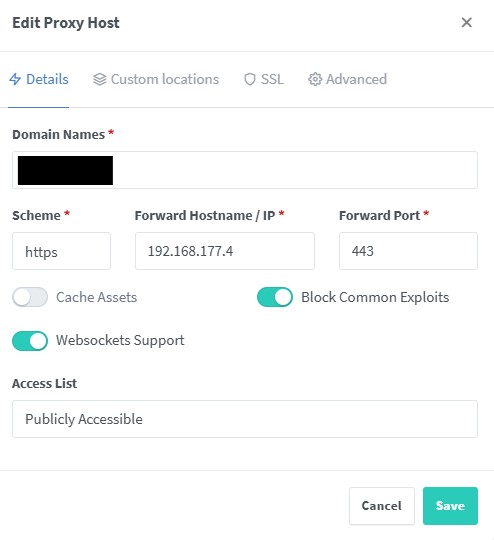

NGINX Proxy Manager configuration
If used, add the following configuration in NGINX Proxy Manager under Advanced: location /exapps/ {
proxy_pass ``http://YOUR-INTERNAL-IP:8780``;
proxy_set_header Host $host;proxy_set_header X-Real-IP $remote_addr;
Also, activate or deactivate the following items in the web server configuration in NGINX:

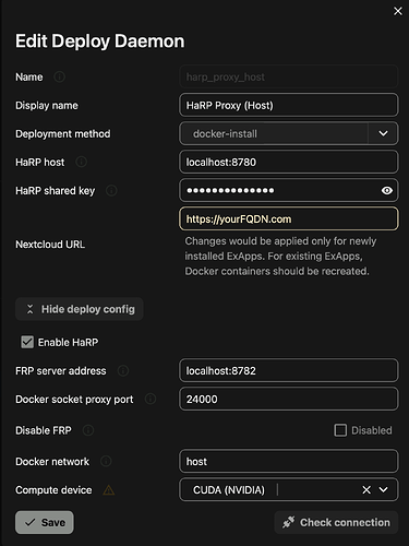

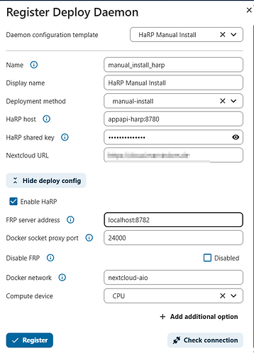

Nextcloud AppAPI - Daemon configuration
In Nextcloud, go to the administration area on the left, click on AppAPI, then on the + Register Daemon button.
Apply the following configuration.
Important points are:
HaRP host: YOUR-INTERNAL-IP:8780
Shared HaRP key: YOUR HP_SHARED_KEY
Nextcloud URL: HTTPS://YOUR-DOMAIN/index.php

Dies ergibt z.B. bei Portainer folgenden Container:
NGINX Proxy Manager Konfiguration
Wenn genutzt - folgende Konfiguration im NGINX Proxy Manager im Punkt Advanced einfĂŒgen
location /exapps/ {
proxy_pass http://YOUR-INTERNAL-IP:8780;
Außerdem in der Konfiguration des Webservers im NGINX folgende Punkte entsprechend aktivieren bzw. deaktivieren:
Nextcloud AppAPI - Daemon Konfiguration
In Nextcloud im Administrationsbereich links auf den Punkt AppAPI, dann auf die SchaltflÀche + Daemon registrieren
Folgende Konfiguration anwenden
Wichtige Punkte sind:
HaRP-Host : YOUR-INTERNAL-IP:8780
Gemeinsamer HaRP-SchlĂŒssel : YOUR HP_SHARED_KEY
Nextcloud-URL : HTTPS://YOUR-DOMAIN/index.php

Hello,
sorry for the late response. Had little time and other important topics.

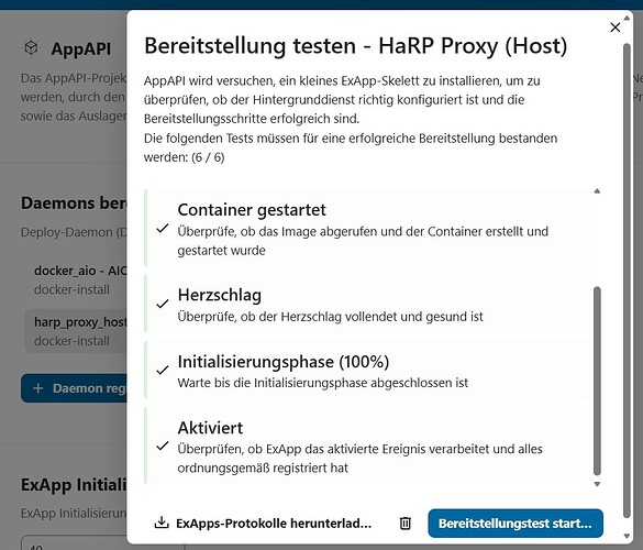

It still isnt working. Weird enough whatever i did now Collabora and Notes are working again on my server but the AppApi TestDeploy still fails.
The logs says heartbeat error and before that the test-deploy app is disabled, but i think the error happens before all of this.
I think that he fails to pull the image. That’s just my guess.
When i have time i will look further into this. If anyone has a suggestion please tell me.
:slight_smile:

Let’s try something different. Maybe that will help us track down the error.
You’re using Nextcloud AIO, right? The setup includes the option to use/activate AppApi-DSP. This happens automatically and is configured correctly.
Have you already used this? If not, could you please enable it? You can also run a test there. The same test container is used for this. The connection will then run through Docker Socket Proxy, but if it works, it will rule out errors in your Docker server. That would bring us one step closer.
when i set up AIO i also installed the DSP. After configuring the new APPApi Connector i removed the DSP Connector but i think the container is still there. I never tried to use it :D. I just saw the warning to move to harp and then started xD.
