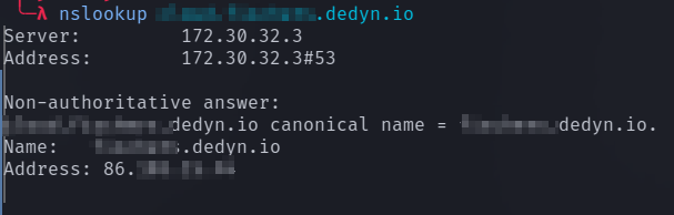

I got a ddns at desec and created a CNAME for AIO:
