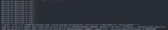

I also check nc -z cloud-ip11000; echo $? from the reverse proxy and it returned 0. Output from mastercontainer logs below. https://your-domain-that-points-to-this-server.tld:8443 doesn’t work either
Here’s my apache container logs as well:
