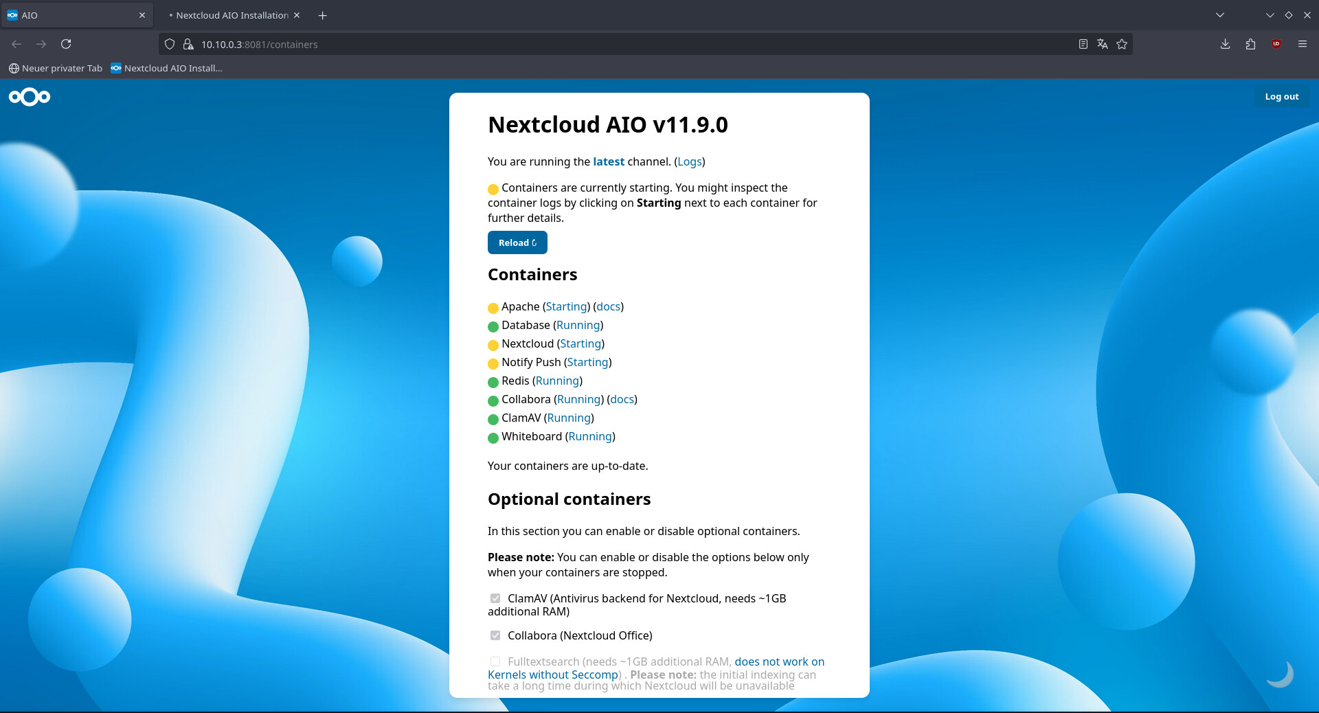

Thanks! Can you please post a screenshor of what you currently see when you log into the aio interface running on port 8081 on this server?
Ok and can you click on (Starting), next to the Nextcloud container and post the logs here?
2025-10-07T20:12:42.445937102Z Connection to nextcloud-aio-database (172.18.0.6) 5432 port [tcp/postgresql] succeeded!
2025-10-07T20:12:42.446926500Z + '[' -f /dev-dri-group-was-added ']'
2025-10-07T20:12:42.447490289Z ++ find /dev -maxdepth 1 -mindepth 1 -name dri
2025-10-07T20:12:42.448451848Z + '[' -n '' ']'
2025-10-07T20:12:42.448522738Z + set +x
2025-10-07T20:12:42.474784768Z Enabling Imagick...
Hi, see Container hangs at "Enabling Imagick..." after automated backup restart - #20 by redhawk07
Thank you very much. It worked.
