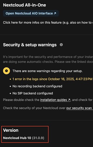

I came across a strange anomaly during my upgrade from 31 to 32 AIO.
In my NC admin page it shows I’m running Nextcloud Hub 10 (31.0.9)

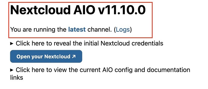

But when I’m in the admin interface it shows I’m running Nextcloud AIO v11.10.0
Also my AIO docker install shows the old interface icons and background image.
Is it possible it did not complete, can I force an update again?

Hi, how exactly did you do the update? Did you follow How to update to `Nextcloud Hub 25 Autumn` now? · nextcloud/all-in-one · Discussion #6865 · GitHub?
I did not update using the beta channel. I didn’t need to, the update showed up in the admin interface, I closed the containers, clicked update… maybe the master container did not update?
If you did not update via the mentioned guide manually, you are still on nc31. AIO v11.10.0 does still ship nc31 currently. So things seems to work as intended.
@szaimen then that must be it! Thanks. Thought I might have done something incorrectly.
