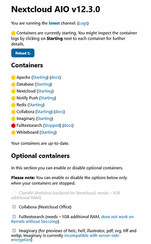

Nextcloud AIO containers all stuck on "Starting" on Synology on first setup

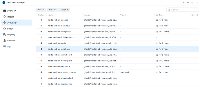

Nextcloud AIO /containers page shows all containers as “Starting”, with a yellow dot. Except for the Fulltextsearch, which is Stopped red (due to me stopping it, after I realised I had installed it despite my platform not supporting Seccomp, but the “Optional containers” checkbox being greyed out even when it’s stopped).
Many of these containers show as green/healthy in the DSM Container Manager
  1. Start the aio mastercontainer through the DSM Container Manager UI
  2. Proceed through the web UI, specifying desired apps
Waiting for database to start...

I don’t know where to run occ as recommended. execing into the nextcloud-aio-nextcloud container gives occ: not found, as does the mastercontainer.
  • Collabora (with seccomp disabled)
  • Fulltextsearch (because I made a mistake and can’t turn it off)
  • Imaginary
  • Whiteboard
Hi, can you post the output of sudo docker logs nextcloud-aio-mastercontainer; sudo docker inspect nextcloud-aio-mastercontainer here?
Hey sorry, looking at the output of the logs command, it looks the same as what I already provided? Am I missing something?
But here’s the inspect output:
docker inspect nextcloud-aio-mastercontainer output

Infortunately the logs you provided are incomplete, thus please post the complete output of the docker logs command.
Thanks!
Oh, ok. It’s mostly just repeating the exact same error over and over again, but here it is:
mastercontainer logs

DOCKER_API_VERSION was found to be set to '1.43'.
Please note that only v1.44 is officially supported and tested by the maintainers of Nextcloud AIO.
So you run on your own risk and things might break without warning.
WARNING: No kernel memory TCP limit support
WARNING: No cpu cfs quota support
WARNING: No cpu cfs period support
WARNING: No blkio throttle.read_bps_device support
WARNING: No blkio throttle.write_bps_device support
WARNING: No blkio throttle.read_iops_device support
WARNING: No blkio throttle.write_iops_device support
Initial startup of Nextcloud All-in-One complete!
You should be able to open the Nextcloud AIO Interface now on port 8080 of this server!
E.g. https://internal.ip.of.this.server:8080
⚠️ Important: do always use an ip-address if you access this port and not a domain as HSTS might block access to it later!
If your server has port 80 and 8443 open and you point a domain to your server, you can get a valid certificate automatically by opening the Nextcloud AIO Interface via:
https://your-domain-that-points-to-this-server.tld:8443
/usr/lib/python3.12/site-packages/supervisor/options.py:13: UserWarning: pkg_resources is deprecated as an API. See https://setuptools.pypa.io/en/latest/pkg_resources.html. The pkg_resources package is slated for removal as early as 2025-11-30. Refrain from using this package or pin to Setuptools<81.
  import pkg_resources
{"level":"warn","ts":1766323776.2347498,"msg":"failed to set GOMAXPROCS","error":"open /sys/fs/cgroup/cpu/cpu.cfs_quota_us: no such file or directory"}
{"level":"info","ts":1766323776.235262,"msg":"GOMEMLIMIT is updated","package":"github.com/KimMachineGun/automemlimit/memlimit","GOMEMLIMIT":3671407411,"previous":9223372036854775807}
{"level":"info","ts":1766323776.235326,"msg":"using config from file","file":"/Caddyfile"}
{"level":"info","ts":1766323776.2369761,"msg":"adapted config to JSON","adapter":"caddyfile"}
{"level":"info","ts":1766323776.2388434,"msg":"serving initial configuration"}
[Sun Dec 21 13:29:36.583345 2025] [mpm_event:notice] [pid 146:tid 146] AH00489: Apache/2.4.66 (Unix) OpenSSL/3.5.4 configured -- resuming normal operations
[Sun Dec 21 13:29:36.583391 2025] [core:notice] [pid 146:tid 146] AH00094: Command line: 'httpd -D FOREGROUND'
[21-Dec-2025 13:29:36] NOTICE: fpm is running, pid 151
[21-Dec-2025 13:29:36] NOTICE: ready to handle connections
