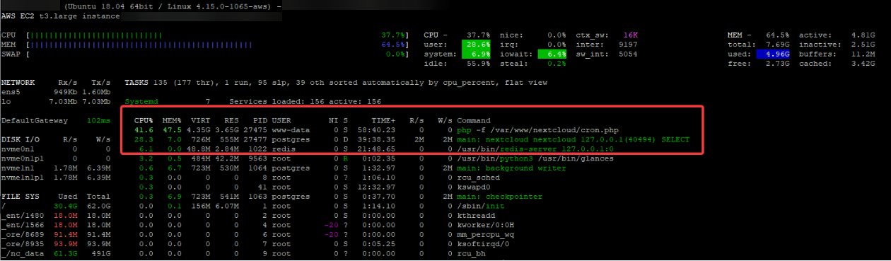

I ran into a similar issue where my server was crashing due to an out_of_memory issue.
What I did find is that one of the External Storage shares that I had configured was causing an error with the background update task. This causes the NextCloud cron job to get stuck and keep consuming memory until the server ran out and crashed.
After removing the external storage that was causing issues, I saw a major drop in resource usage.
