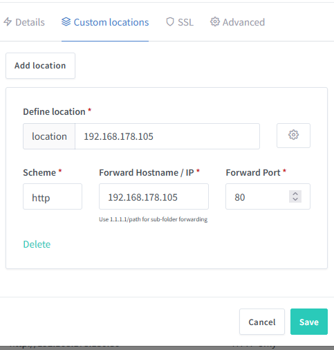

Nextcloud 16.0.1 behind Fritzbox -> NGINX Proxy Manager -> NextcloudVM /Debian11on ESXi7
I can reach my Nextcloud on Esxi with local IP
I put in the credentials in NPM → bad gateway
grafik
But when I put in the IP of an old version also running on the same server at V 25.0.6
I can see the login screen with my domain from NPM.
grafik
grafik

But locally, you are using port 80? I don’t really get the point of the second screenshots with the custom location, is that for local access (for the firewall?)? Or you need the custom location first and then create the forwarding from outside to it?

I dont know either about port 80
Fact is that these settings work with old nextcloud VM IP
But not with new VM IP
So this should not be the point of the Problem?
What do you think?

Was your use of port 433 (versus 443) intentional?
Also, to clarify: are you saying both of these work for you from your local network:
http://192.168.178.105
http://192.168.178.185
But when you try to access from outside your local network (and therefore via your NGINX Proxy Manager and Fritzbox) using these URLs that you get a bad gateway:
https://192.168.178.105:433
https://192.168.178.185:443
