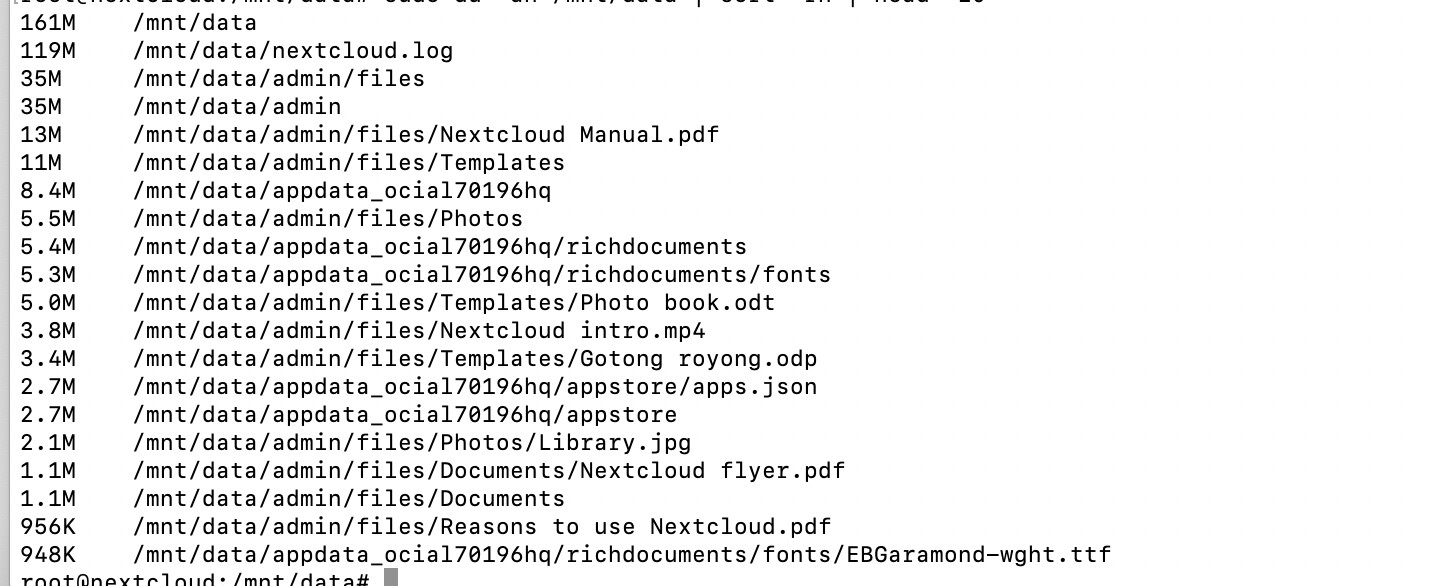

Hii,

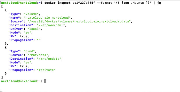

The /mnt/data is mounted to internal docker of /mnt/ncdata
here is du -hs
Also I want to mention that I have nextcloud AIO. Sorry for not mentioning before.
Here is how the directory mounted.
you are aware that (modern) filesystems require metadata? i think the default for ext4 ist ~5% which seems about right for the fs on sdb.
you can reduce that percentage at fs-creation at the price of less fs-resilience. unless you are really hard-pressed for space i wouldn’t recommend it., though.
