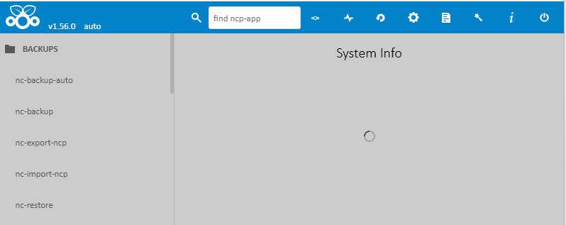

NextcloadPi NCP website unusable( Panel 443): loading icon always remains
I installed NextCloudPi on Proxmox using the community script (as I’ve done many times, including last week).
But now, for the past few days (I’ve tried several times on various Proxmox nodes), the result is always the same.

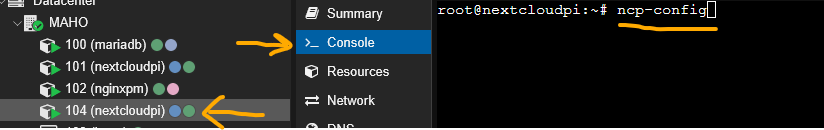

but xtras can be activated and configured using the from panel 4443 Or the command line using ncp-config (shell)
I have the exact same problem. Anyone found a solution?

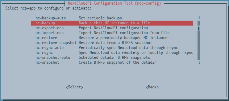

but you can use this - xtras can be activated and configured using the command line comand : ncp-config (console
as you se at last picture. its same xtras that you have at web Panel
Looks like nc-init is always running, thats why the ncp panel is not working. After killing nc-init on startup, the ncp panel is working fine now :ok_hand:t4:
