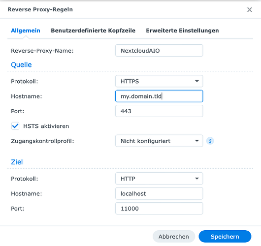

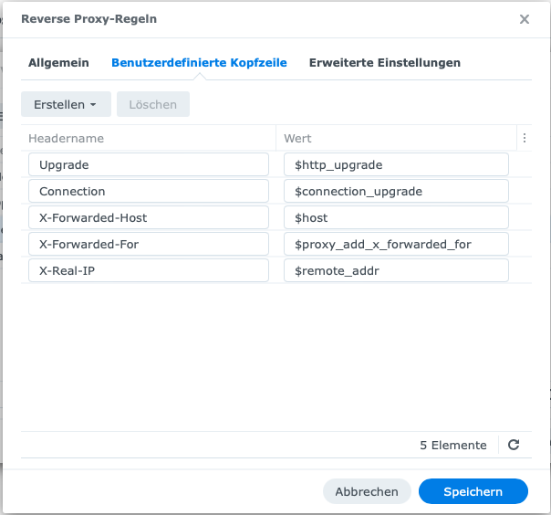

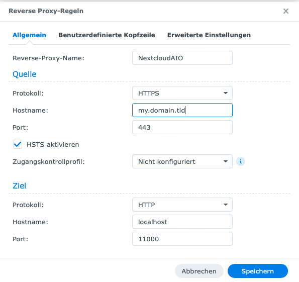

    Synology internal reverse proxy
    directly after installation
    Nextcloud AIO without Callabora (replaced by OnlyOffice
    No
Nextcloud Talk with HPB entered seems to work in the Admin Panel: The rest reports "running version 2.0.2-docker
It also resolves the Url for Nextcloud Basis, Talk Backend Websocket URL and shows the available functions.

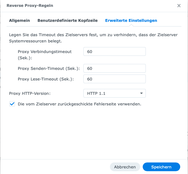

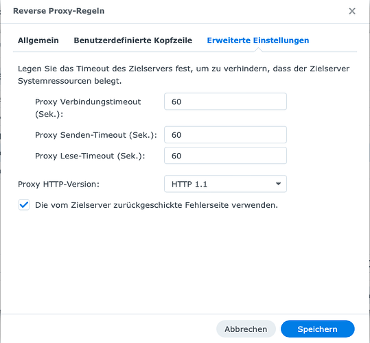

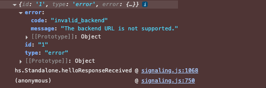

If I however connect via browser (tested Safari and Chrome) to the talk section of the webinterface, an error occurs saying that it could not connect to the signaling server.
If I remove the HBP it works fine.
If I use the dedicated app, it also works fine.

My reverse Proxy settings are the following:

The chrome console shows a lot of errors. I think it might be this, but I am lost if I have to solve this:
signaling.js:1068 Could not connect to server using backend url https://my.domain.tld/ocs/v2.php/apps/spreed/api/v3/signaling/backend {id: '1', type: 'error', error: {…}}
hs.Standalone.helloResponseReceived @ signaling.js:1068
(anonymous) @ signaling.js:750
signaling.js:638 Reconnect in 805.933985015647
signaling.js:803 Ignore unknown error {id: '1', type: 'error', error: {…}}
(anonymous) @ signaling.js:803
