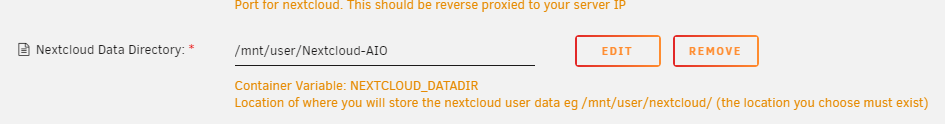

I am pointing Nextcloud AIO to it’s own share called Nextcloud-AIO
I don’t have any folders called NAS or MAGIC.
or anything in “/mnt/remote/storage/nas /var/local/magic/nextcloud/mount”
So i’m not really how those commands should work?

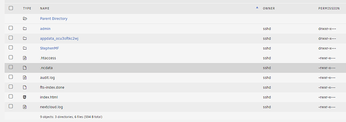

the problem is located around data directory access.
even it doesn’t seem to make sense from the log output… you should review the docker bind/volume mount instructions and share your compose/docker run together with the datadir permissions list (ls -al).
the owner sshd from your screenshot seems strange… usually 33 is webserver user…

Owner and permissions are listed above in the screenshot of the Docker/nextcloud data folder.
( /mnt/user/Nextcloud-AIO )

new user, one folder deeper.
user sshd I guess is made by Nexcloud AIO master docker?

Just to link the code in question, this error comes up if the web server user running inside the container (uid 33) cannot write into the configured data dir: all-in-one/Containers/nextcloud/entrypoint.sh at 77dd56bade11cbb6ecffe8f2ada381520a16f5d6 ¡ nextcloud/all-in-one ¡ GitHub
And yes, I think uid 33 is the sshd user on unraid…
Can you run sudo docker inspect nextcloud-aio-nextcloud | grep /mnt/user/Nextcloud-AIO and post the output here?
Full disclosure.
I am not a coder - I use computers by pressing buttons :slight_smile:
So this is very unfamiliar to me.
All my other dockers work by just pressing buttons.
And I really appreciate your effort.
root@EskiUnraid:~# sudo docker inspect nextcloud-aio-nextcloud | grep /mnt/user/Nextcloud-AIO
“/mnt/user/Nextcloud-AIO:/mnt/ncdata:rw”
“Source”: “/mnt/user/Nextcloud-AIO”,
