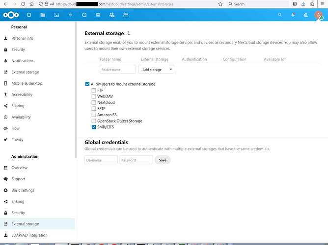

I use nc as a frontend for my External Storage, I don’t like having multiple copies of my stuff, and my smb share is primarily used by my desktop workstation. This allows me to keep nc as a vm with only enough drivespace for itself.
I do know that nc can indeed be a file server and offer a share to workstations on the lan, but I have been using Veritas Backup Exec to backup from my smb for decades and really gotten used to how it works.
Yes, I don’t have enough space to keep it full of copies of the same thing :sweat_smile:.
My goal with NC is to have my own online Drive, since I share a lot of files with my family/friends. If I can do it using the drives as external storage, it will be much easier.
Can you show me how you’ve implemented it?
If you keep nc stricly as a frontend with zero data on it, then yes, you can share everything off External Storage only. I’m not crazy throwing everything to be stored by nc because I am fairly new to nc and that thing can die anytime after an update, whatever.
My smb External Storage is a Windows fileserver.

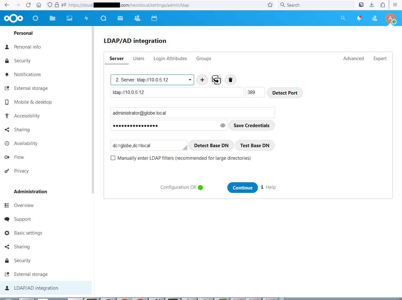

I have nc setup from the start as a standalone appliance without joining a domain, you know, the beginning part where it asks you what city you are in and keyboard, etc.
Logging in as administrator, I add a second ldap server. I realized nc can both use its built-in user groups as ldap from my Windows Domain. I do this so each user in my household has their own login.
When a user logs into nc, each user mounts their own External Storage by themselves.
Ok, I think I got the part about adding external storage for other users. Although my NC is in Docker, since the connection is via a network, I think it will be able to detect it without having to mount it in the container. It’s better that way. Thanks.
What I didn’t understand was the LDAP part. I’m very new to self-hosting. My entire setup is a laptop with docker, a USB drive and connected hard drives :sweat_smile:. But I understand that part is for managing the other users on your network with your Windows Domain. I don’t think I need it for now.

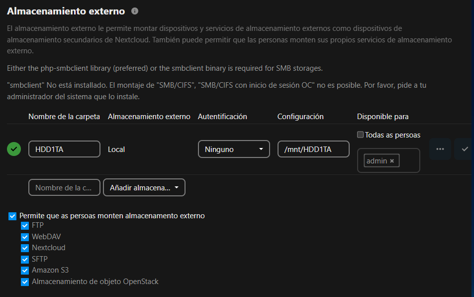

I think I managed to add external storage. I did it locally so I wouldn’t have to create an SMB server since I don’t need it.

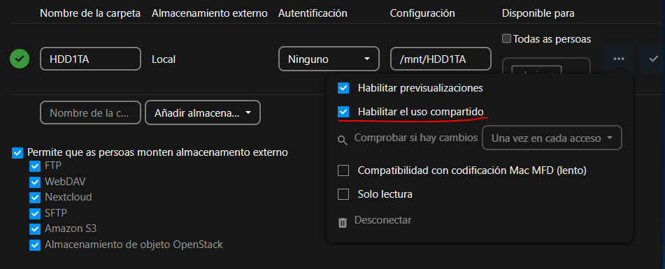

But I’m unable to create links to share the folder/files. Is that expected, or do I need to adjust something in the settings?
Edit: Yes, just activate the option in the mounting options.
