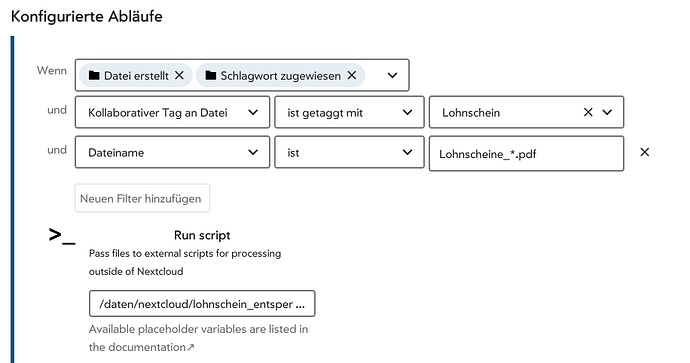

How should I enter the file name and which variables should I give to the script so that it works?
I have read the other posts about workflow_script, I can’t find a solution there. I have tried different variables that I found in the answers, but it does not work.
I receive the payslip from my work as a PDF document with a password. Now I want the password to be removed when uploading to Nextcloud. I have written a script for this. This works when I pass the corresponding file to the script. Now I want to automate it in Nextcloud and integrate the script via workflow_script (Script external).
But I can’t get along with the variables for the filename and when executing the script.
The documents have a recognisable name with an changing date (Name_YYYYMM) and the extension pdf.

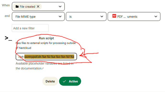

Here is, what I use for my scripts.
I call my scripts with script.sh %e %i %a %o %n %f %x so I have all the info to handle. In the script.sh I start with setting variables from the arguments.

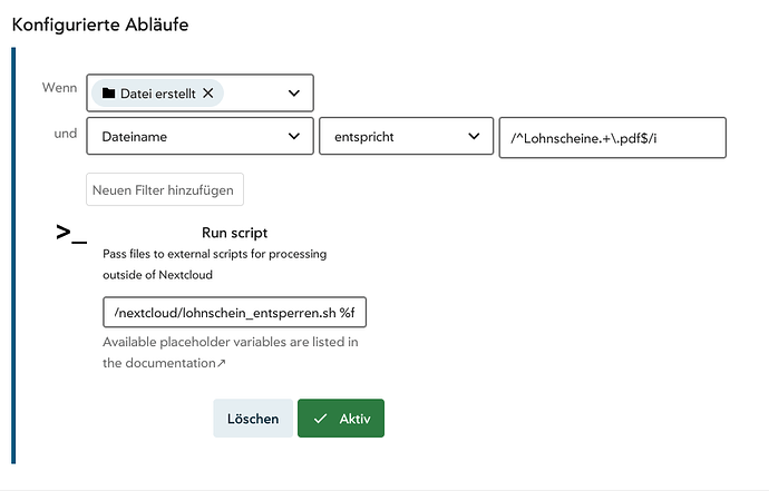

And what about the file name of the PDF? In the forum I saw many different spellings with placeholders and variables like “/filename.pdf" or " /…pdf$/i*”. I tried all of them I found without understanding exactly what the variable symbols do. Didn’t work either - which was no surprise.
I always have a PDF. It has a static beginning of the file name “Lohnscheine” and then follows a variable number sequence for which I need a wildcard. How should I enter this in "Filename - is - "?
IS checks the string and I don’t know about wildcards. MATCHES uses regular expression matching using the PHP function preg_match().
Use regular expression Filename matches /^Lohnscheine.+\.pdf$/i
explanation for the matching rule / the slashes enclose the rule ^Lohnscheine matches name starting with Lohnscheine .+ the DOT matches ANY character including dot and the PLUS tells it must be
one ore more \.pdf$ matches dot pdf at the end of text i after the closing slash indicates to match case insensitive
Wow, thank you very much for your explanations. It finally works. I would never have thought that the variables came from PHP. But I’m not a specialist either.
