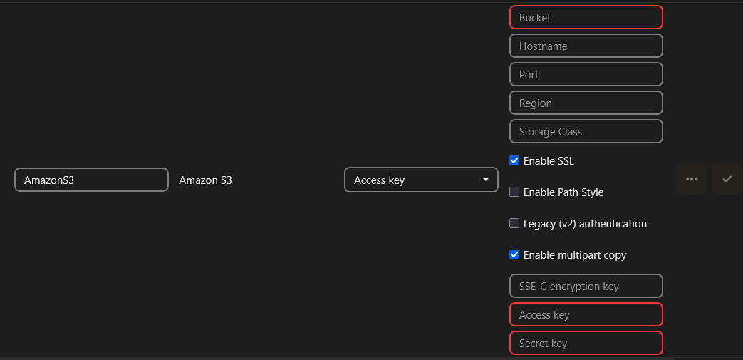

I am connecting to a S3 Type External Storage Service (Wasabi) using the App “External storage” in NC.
I left the SSE-C key field empty during setup. The connection works. I notied that after saving my settings my SSE-C key field gets filled in with dummy bullet points (confusing!). The field in the table oc_external_config.key sse_c_key is still empty.

During the setting up of my first bucket (external storage) I left the SSE-C field empty. Using that connection works. I can upload directly to my bucked externally, not using NC but using rclone, and connect to my bucket using NC, see and download my files.
If I where to enter a value in the SSE-C field, is it AES256? And I suppose that would only really matter for when NC uploads to a S3 bucket, right? As far as I understand it has no meaning when downloading files from a S3 bucket through NC.
If you configure SSE-C in a given bucket, Nextcloud will use it for all objects in the bucket.
