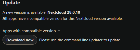

I’m trying to update NextCloud that is in a Docker container and I’ve had no luck anywhere.
Next cloud is wanting me to update via command line.
When I attempt to use command line to update the OCC (path: /var/lib/docker/volumes/Nextcloud_Application/occ)
It is unable to open the OCC file from outside of the container.
So when I go into the container and attempt to update it that way, I will get:
root@802d9c7ef14f:/var/www/html# ./occ upgrade
Console has to be executed with the user that owns the file config/config.php
Current user id: 0
Owner id of config.php: 33
Try adding 'sudo -u #33' to the beginning of the command (without the single quotes)
If running with 'docker exec' try adding the option '-u 33' to the docker command (without the single quotes)
I have tried ./occ upgrade -u 33 and I get the same message.
I’m at a loss.
