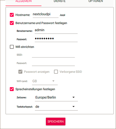

How did you write the NextCloudPi Image for RP4 (v1.54.0) on what medium?
I like the raspberry way
grafik
You are enabled to do some settings.
I wrote the image using win32diskimager on a std SD card (32GB).
Does raspberry way mean using raspbian os imager tool? Is this compatible with armbian?
Sorry, on my mobile i did not see you images.
Thank you, I will try using imager.
Yes and No.
Yes, that’s what I wanted to express and
no, it’s not fully compatible, but the settings, rootuser / password and ssh should work.
Thank you very much, flashing the image using Raspbian OS imager did the trick: both ssh login was possible as well as connecting to activation page using actual firefox.
