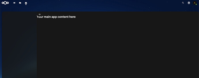

I try to build a minimal vue-example and did a lot of reading, but: NcContent makes me crazy. The App-Generatpr creates an App with NcAppContent, but the documentation and NcAppNavigation says, i MUST use NcContent as the main wrapper. But look at the result:
And here is the code of my App.vue

Ok, i found the solution. The Problem is not in the packages, it is the mount-point of the vue-app. You NEED to set the id of the main-div where to mount the app-app to content!
This is the main.js
import Vue from 'vue'
import App from './views/App.vue'
Vue.mixin({ methods: { t, n } })
const View = Vue.extend(App)
new View().$mount('#content')
And the main.php (or index.php, depends on the TemplateResponse in the index-function of the PageController.php)
<?php
declare(strict_types=1);
use OCP\Util;
Util::addScript(OCA\MyStupidApp\AppInfo\Application::APP_ID, 'main');
<div id="content"></div>
I also checked some css-Files and Vue-NC-Files and the content looks like the correct class where the correct behavior is set. Well, in my opinion its pretty bad cause the skeleton-app-generator creates an app with that bug. If you change the default-skeleton-app to the code in the Vue-App as said i the documentation you get that wrong behavior. It should be fixed!
