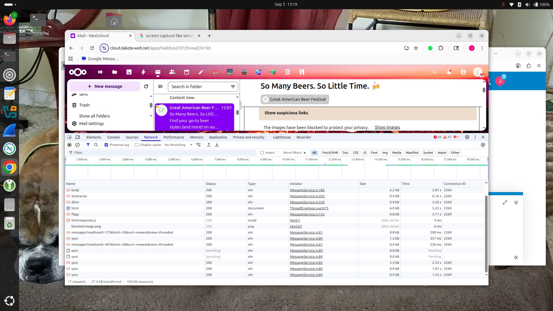

Opening a developer console I will see the following
Can you monitor the Network tab in the inspector to see which transactions are actually the slow ones for you?

Here is a screen shot of an email being opened
Thanks after taking a couple runs at trying to fix this it appears there is nothing I can do to resolve. Tried to install snappy from git hub never could get that to work. Installed round cube but could never get it to support multi domain. Finally with a bit of haproxy and nginx reverse proxy magic I was able to make cypht work in a frame. Not a spectacular product but it just works. I am going to be away for at least a month and need something I can depend on. I may try the nextcloud mail product again some time. Truthfully if I had not found a solution I would have been shopping for a new total integrated product. I may need to do that eventually but for now I need to spend more time using the product than maintaining it.
