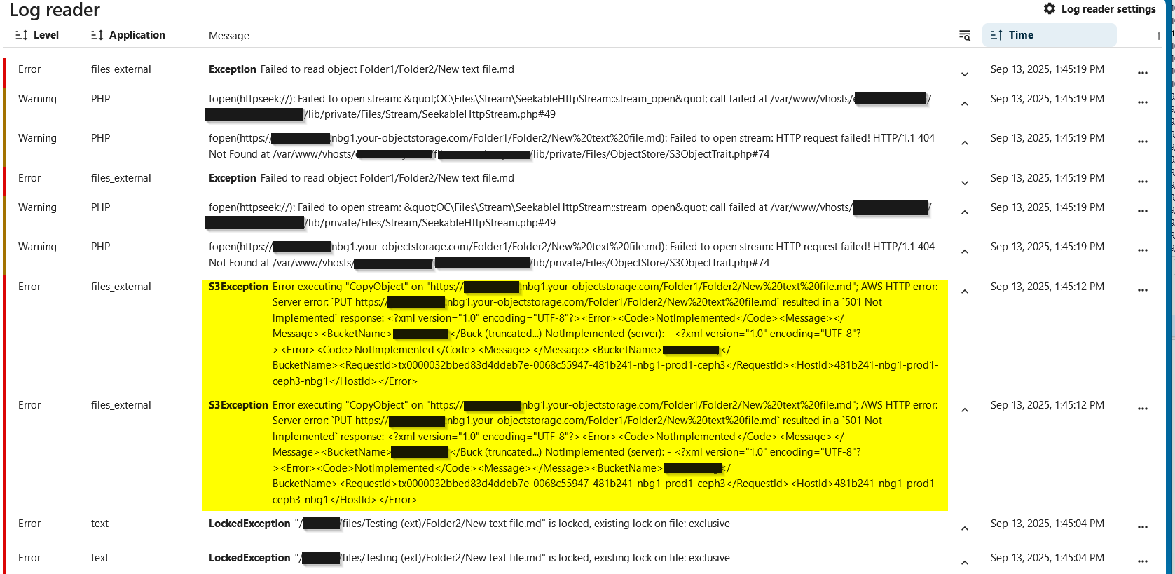

Can you share one of the Nextcloud log entries with the 501 it? (Or whatever is generated in the Nextcloud log when you attempt this).
Based on a quick glance I would expect this to be handled already, but perhaps not.
Sure, here below what happens when I do exactly what I described in my original post. During this, the NC web interface reports success for the move and afterwards, “New text file.md“ is gone. What I found in addition is that if I navigate very quickly to Folder1/Folder2/, the file appears there for a split second before it disappears.
@jtr Is the log I posted as screenshot good enough and will this be handled? Or would it make sense for me to report it somplace else, too?
