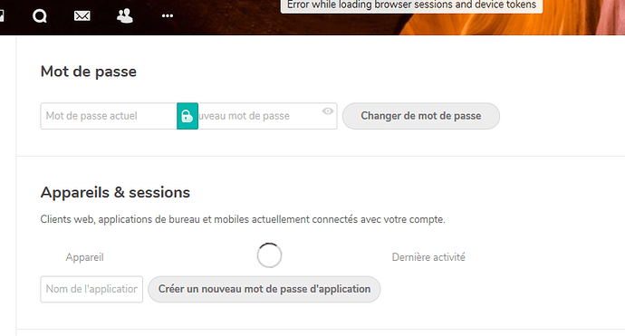

I cannot see anymore my token. i have
Error while loading browser sessions and device tokens

i cannot create token anymore
The browser debug console might provide some useful output then.
Ah Yes, look at that !
